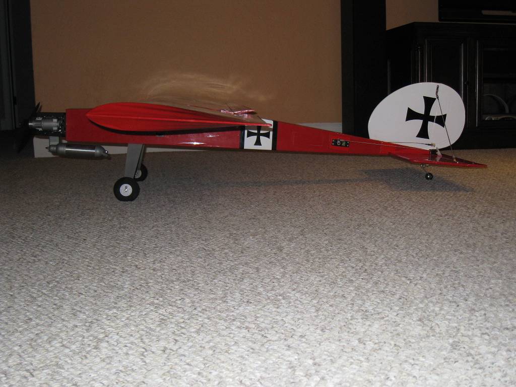

I've done this conversion on my Big Stik 60. You'll need to use a piece of ply and create a landing gear block to epoxy inside the fuse and yes, you need to reinforce it with triangle stock. I also used blind nuts so that I could retain use of the stock screws used to hold the gear in place. I placed gear block just behind the former so that the gear is basically aligned with the leading edge of the wing.
I went with the approach to link the tail wheel to the rudder. If you haven't already glued the rudder and stab in place, this will be much easier.
Having done it, I would say while it looks cool, it wasn't worth the effort. Plus the ground handling isn't anywhere near as stable as the nose wheel setup. If you do go this route, I'd recommend the approach to use an additional servo for the tail wheel as shown above by Diglivin and Y connect it to your rudder servo. This way you don't need to butcher your rudder and stab with the tailwire.

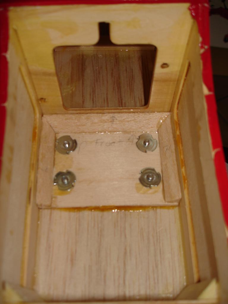

I started the build last night and began with the mods to the main gear mount.
I glued a 1/8 ply sheet to the floor behind F2 and reinforced it with tri-stock. Do you think i'll need any more reinforcement where F2 meets the side fuse doublers?
I'm about to start on joining the wings and glueing the tail pieces on before i tackle the tail wheel. I've bought a Dubro .40 sized tail wheel and it looks like there is enough length in the wire to make it work using w8ye's method.

Old 01-07-2010 | 12:41 AM
w8ye's Avatar
My Feedback: (16)
Posts: 37,576
Received 11 Likes on 10 Posts
From: Shelby, OH
Default RE: Tailwheel setup when converting GP Big Stick to Tail Dragger
By theory, with the addition of the Dubro tail wheel assembly there is no need for the extra fin

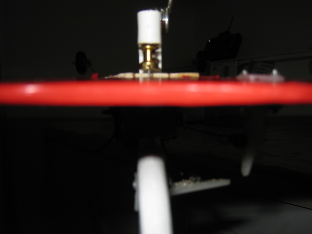

My conversion is complete.
I used a small piece of 1/8" ply to spread the load and give the screws something more substantial to bite into. The wire supplied with the Dubro tail wheel turned out to be too short so i bent a new piece of wire and added some trailing castor as well.
Also note that the wire that is inserted into the rudder is bracketed and clamped by the control horn which will help to ensure that the wire doesn't tear through the balsa rudder.

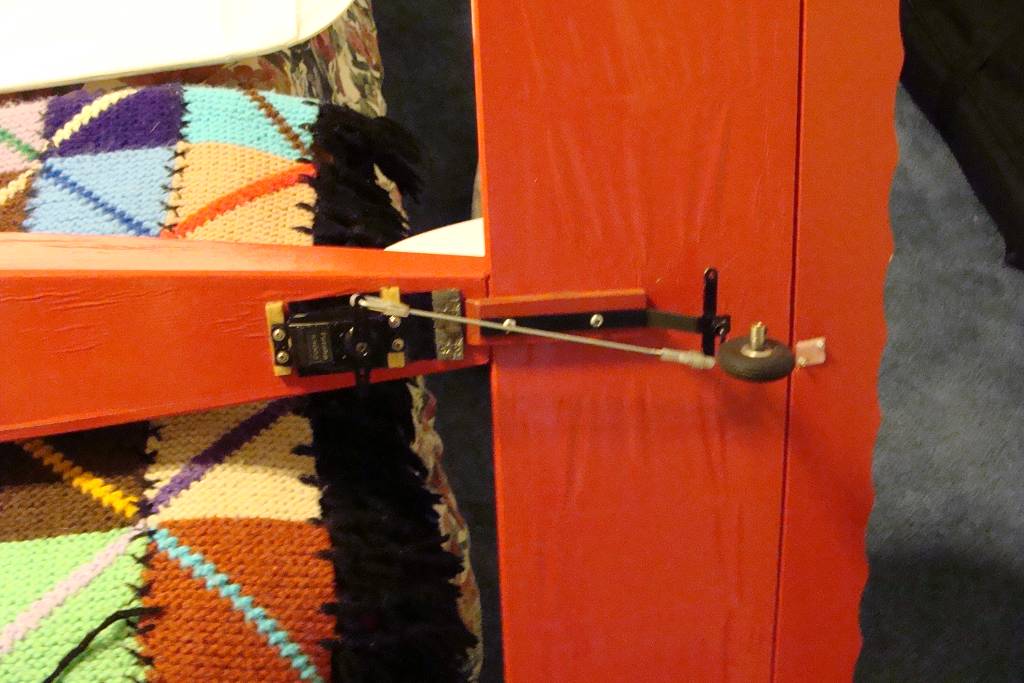

Old 01-08-2010 | 08:46 PM
w8ye's Avatar
My Feedback: (16)
Posts: 37,576
From: Shelby, OH
You did a good job on your tail wheel
That was a nice explanation also.

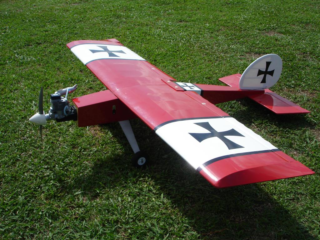

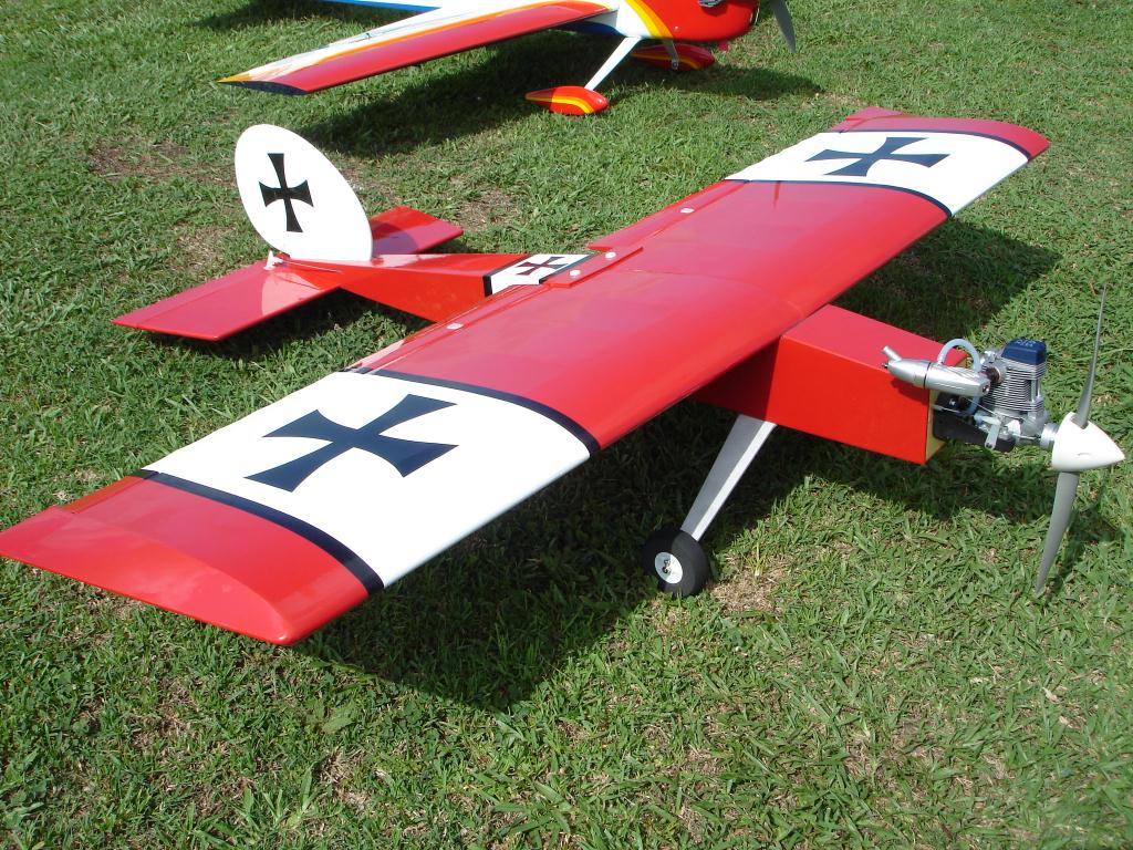

BTW, mine is complete and was maidened a couple of weeks ago.
It flies great and is my new favourite plane. Ground handling is fine but the rudder needs to be on high rate for effective steering.
Mine came out nose heavy with the OS FS .72a up front. The battery is behind the servos and I needed 2oz of lead in the tail to balance as per than manual. I think it will balance with almost no extra weight without the spinner so i'm looking for a lighter spinner option.
The .72 4-stroke is a great match for the plane. With a 12x7 prop it really moves along and is a blast to fly. My engine is mounted upright with the exhaust directed over the top of the wing. There is very little oil slime on the plane after flying.
