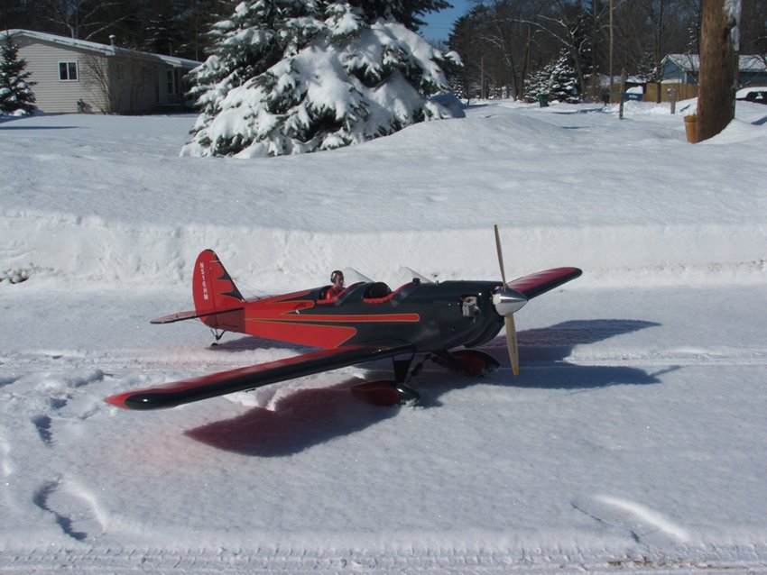

I have a Magnum 1.60 twin in my Sig 1/4 scale Spacewalker.
A match made in heaven !

ORIGINAL: blhollo2
WOW!!! is it very nose heavy??? seems like a hoss! I do like have my planes over powered, thought about an 1.20AX too....I like unlimited vertical
No, she balanced with the battery pack installed under the fuel tank.
I have to admit, it did surprise me, as I expected the SW to be nose heavy with the twin.

not much prop clearance!

ORIGINAL: blhollo2
Ya, unfortunately, you are correct. [&o] It's an 18X6. I may switch to a 16X8 to give me a little more room.

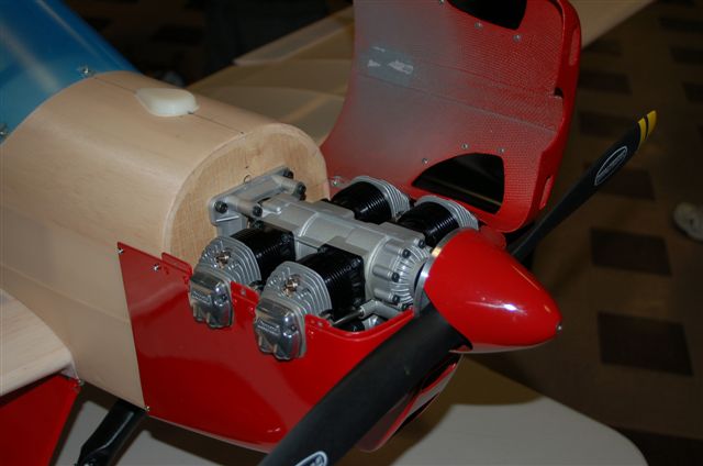

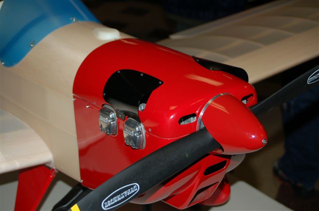

I thought it was the GP model he was talking about. A buddy of mine built the big Sig Spacewalker and put the OS Pegasus 320 4 cylinder in it.
See the pics!

That 4cyl is absolutely beautiful.

It is beautiful. He later installed baffling to direct the air to the cylinders like on a full scale plane.

Bob: I'll bet that motor sounds great, too !!! Your friend did a nice job, splitting the cowl.

I had a 300 Twin. Sounded like a Harley with hot cams when it was idleing. Awesome!
The 4 banger he has is smooth and quiet.
