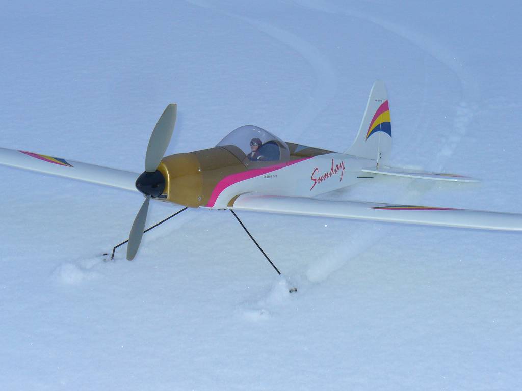

I flew a couple of small electric planes today at our club field in Sidney, Maine. We are in the beginning stages of a big snow storm so this was my only chance. Armed with a shovel to dig out a parking spot, layered clothing and a hooded parka, fingerless knit gloves with palm grip surface from LL Bean hunting supplies and a transmitter mitt I headed to the KVMA field. It was 27 degrees with a North wind blowing 5 or 6 knots gusting to 10 or 15 knots down the runway and light snow falling. The access road was plowed, but the parking lot was not (hence the shovel). Both planes were assembled and the batteries charged before I left so all I had to do was install the battery and walk through the snow to the flightline with my transmiiter in the mitt. It was fun, although a little too windy at times, with my Hobby-Lobby Sunday on Du-Bro mini skis (with a brand new Spektrum radio system) and E-Flite Taylorcraft on foam floats. The Sunday flew great and lifts off very quickly so the skis worked great in the slightly sticky fresh snow cover. The only problem I had was the dim light from the overcast and the all white airplane! Luckily the black spinner and black skis stood out and I kept it in close. So, color, or more important contrasting colors are important too. I had my hands full with the Taylorcraft though as my battery slid back on take-off making it tail heavy and a real bear to handle in the swirling gusty wind. I did manage to get it back on the ground and repositioned the battery and the next flight was much more manageable.
Hope you all had good First day flights.

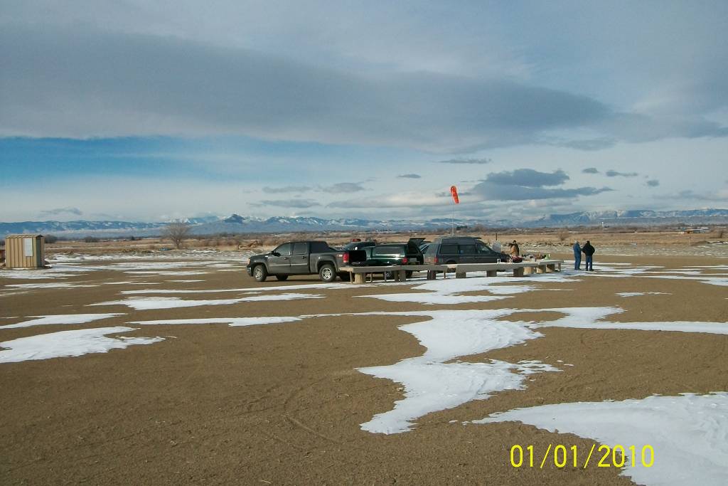

Taylorcraft looks nice! Our club had a little fly-in today; temps in the 20's with a slight breeze. I fly with Mechanixwear gloves; they give decent feel and keep my hands warm enuf for a 10 minute flight. Couple guys in our club have TX mitts; I haven't tried one, but they might be nice, though they look a little restrictive. Kept my batteries in the truck on the defroster vent, and put them in just before the flight. Still lost a couple minutes duration tho...

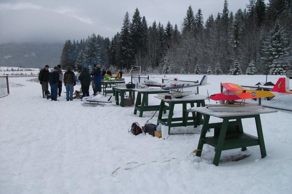

So you learned the secret. Floats work best!. We had 15 at our annual New Years fly, just for a few hours. It snowed at 10AM but by 11AM we had bright sky 34F and about 5 inches of snow, no wind. Perfect!!! Last year I had to hire a tractor and then use my snowblower around the flightline(42 inches of snow, no global warming last year).
No gloves, just hands in pockets for a few minutes before flight. I had a glitch toward the end of my fifth flight and wonder if my A123 had enough at that temp.

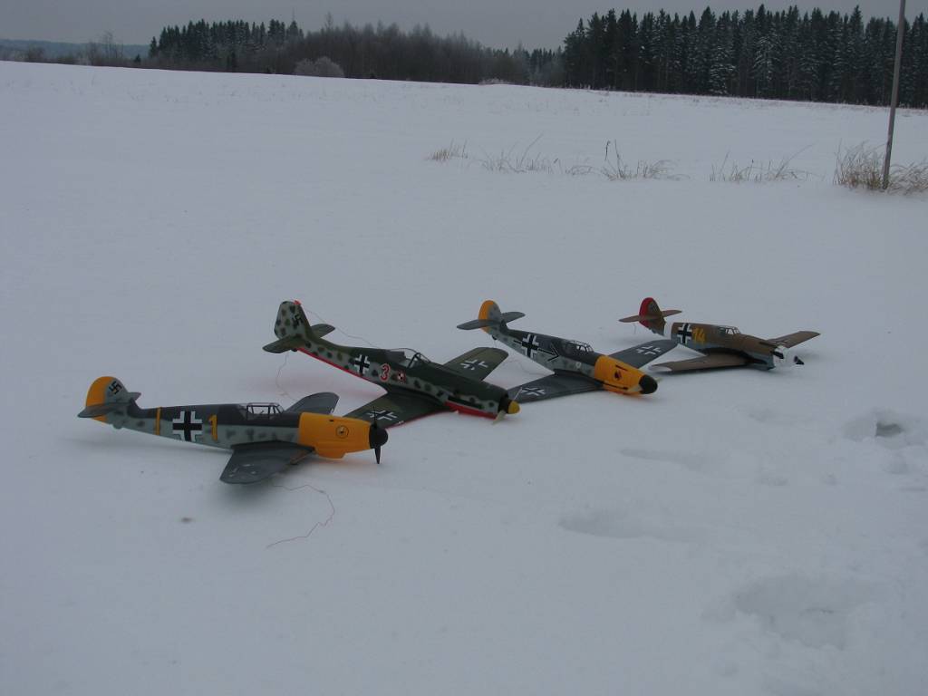

electric planes and no gears.
