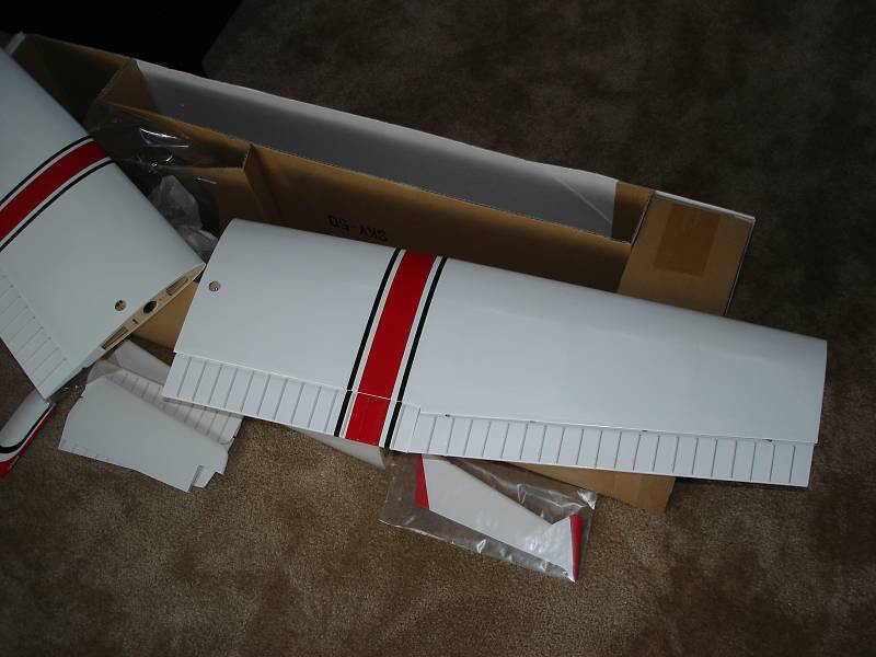

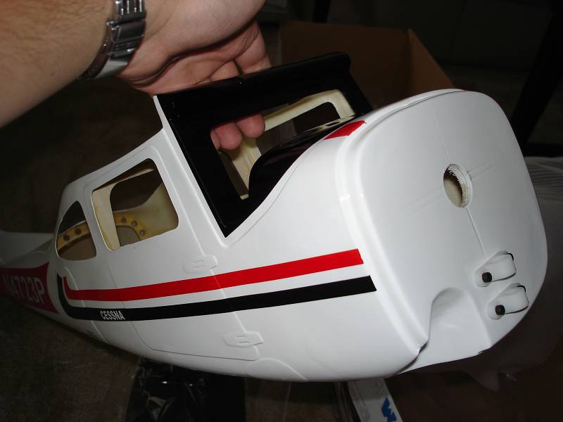

finally got it in!!! It's a beauty, very high detail, good contruction and great hardware!
I'll keep adding pics as I go for those interested in getting it.

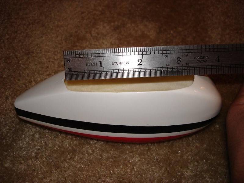

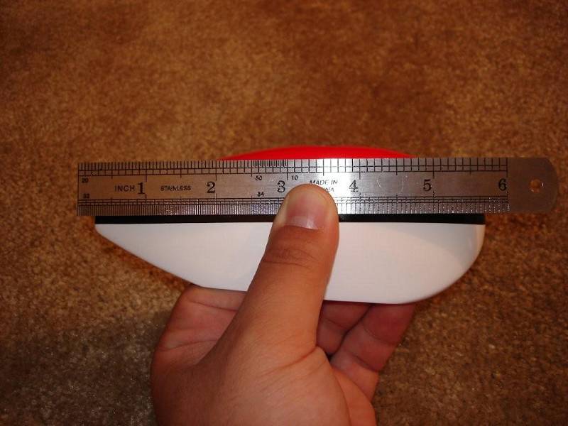

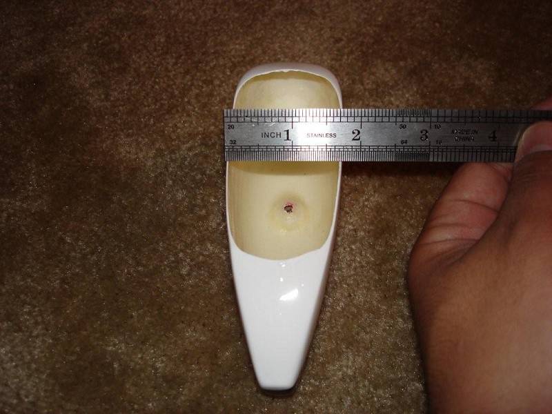

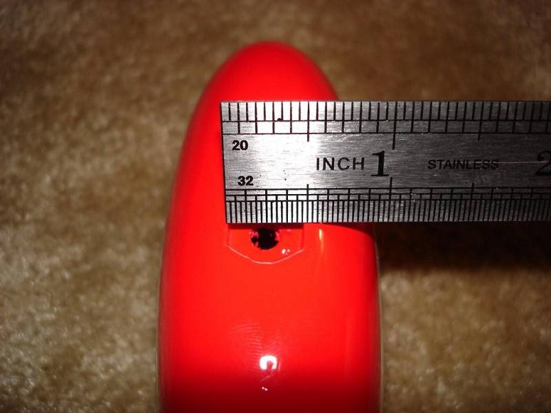

Hi VFR, Could you please tell me how wide the nose wheel pant is (Outside Edge To Outside Edge). I am wondering if I could put a Robart oleo strut on it ? (#654)
Thanks Michael
Thanks Michael

Sure can, I'll check on it tonight after work.

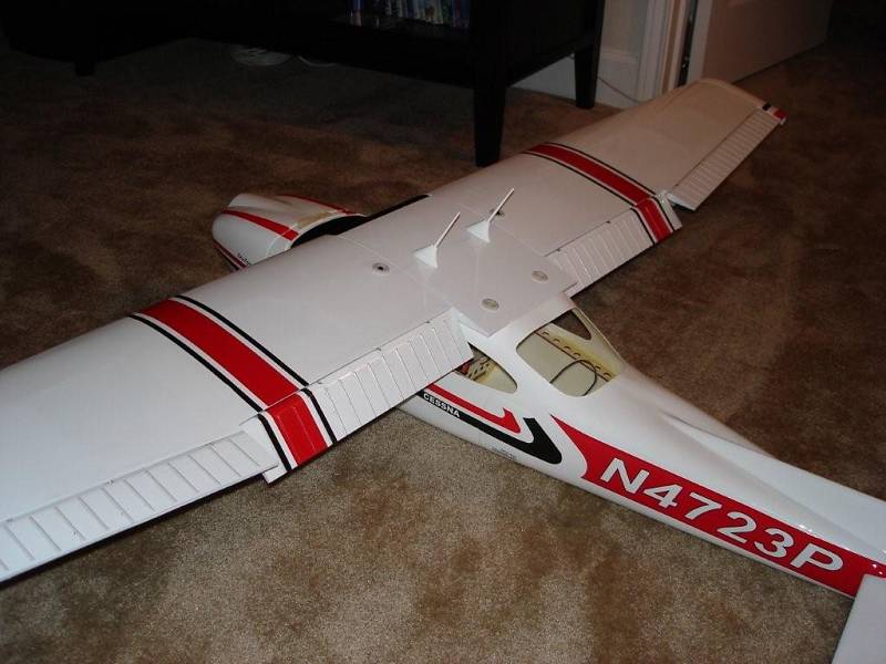

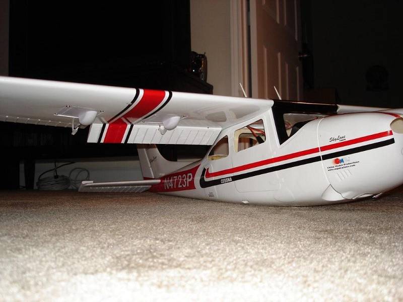

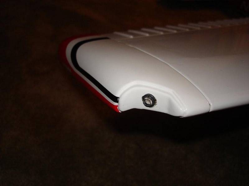

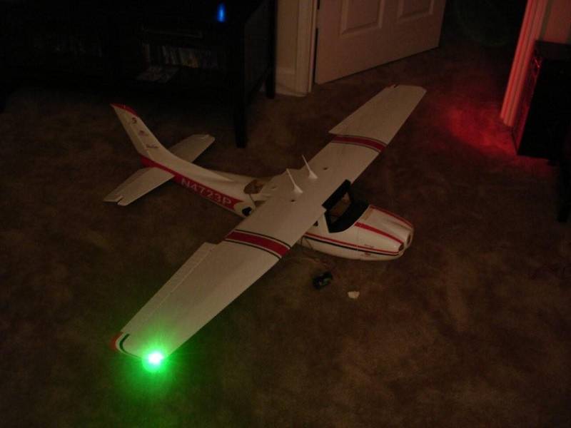

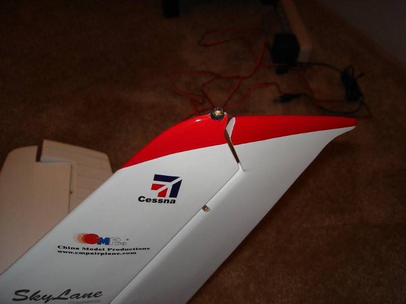

The assembly is going pretty well. The only couple of issues i've encountered are the servo trays in the wing when installed, they will show through the other side (top) of the wing. I had to trim them down some. I also had to trim down the opening a bit so the servo would fit. I am using DS821s all around.
It has taken me quite a bit longer because i am installing NAV lights on the wings and vertical stab. I am not using regular LEDs but the new luxeon super bright 1 Watt LEDs. They are so bright you can see them in plain daylight. I'll post some pics tonight.

i am not at that point yet but the hinges seem ok so far. i epoxied them and pulled on them really hard to check them and they hold.
here are some pics (including the front wheel pant for Michael).
