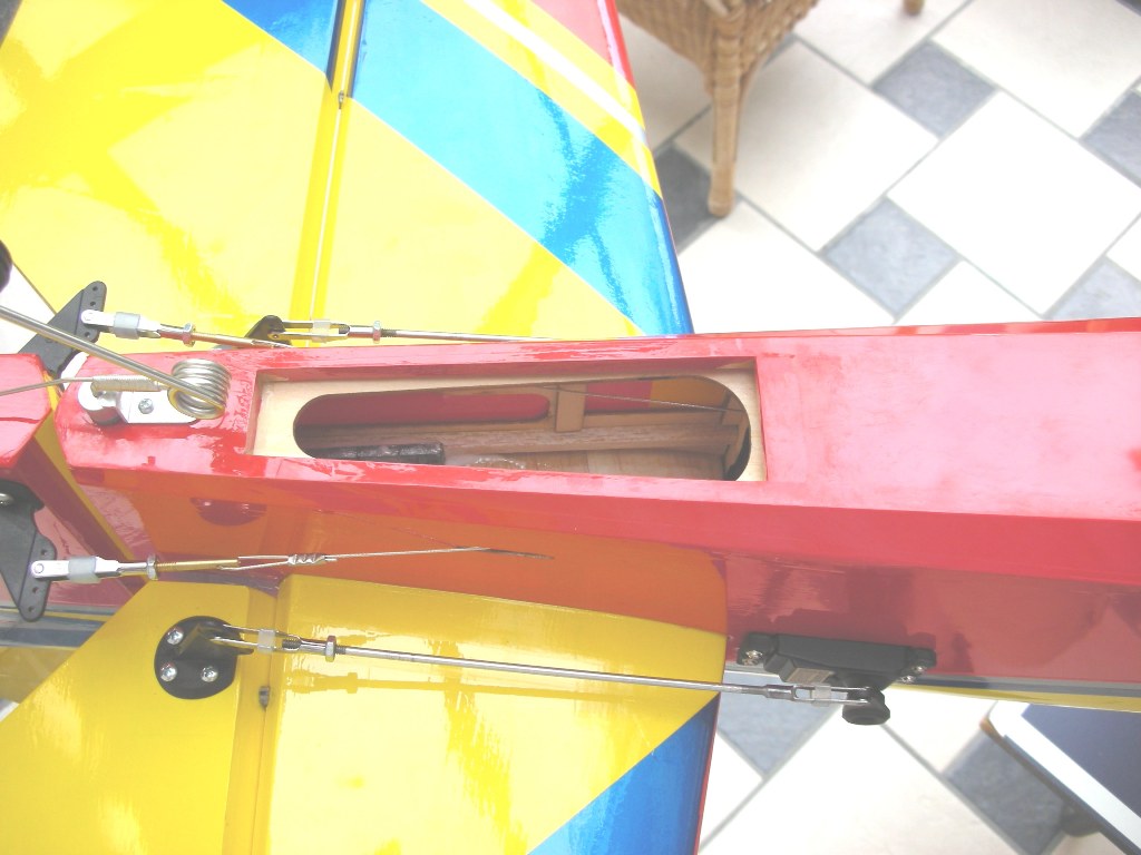

Hello Guitarman.
I've been flying planes similar to yours with similar power plants - several of the 27% GP Extra 330S ARF and I also have the Edge 540 ARF in the same series. Both are powered by DL50s and both required tail weight - around 2-1/2 oz. in the Extra if my memory serves me correct. These planes weren't designed for 50cc engines, thus the nose-heavy situation. Rest assured both of mine fly delightfully balanced as recommended with the tail weight. On my most recent Extra I even mounted the battery near the horizontal stab and it STILL required some tail weight (although I used the pull/pull rudder servo setup instead of the tail-mounted servo which probably would have negated the additional ballast).
Here are some pics of the lead in the tail of one of my Extras.
Hope this helps.
Tim
Hope this helps.
Tim

On the Extra there's no balsa back there (on the bottom of the fuselage). I just cut the MonoKote. But if you examine the photos closely you can detect a balsa stick across the front of the opening between the stringers under the covering. I slipped that in and glued it into position after I cut the hole, then ironed the MonoKote down to it. That way, the covering is supported and you can simply iron a patch into place. If you ever need to adjust the amount of weight you can remove the patch, then replace.
