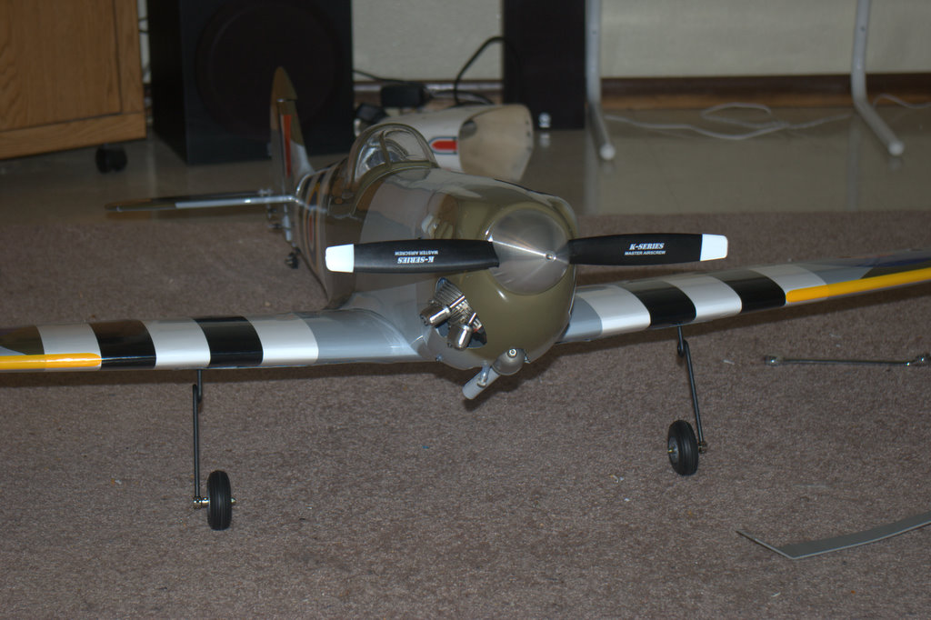

Old 01-21-2010 | 11:32 PM
Joined: Feb 2006
Posts: 15
From: Monterey, CA
Default RE: Phoenix Spitfire 40 ARF

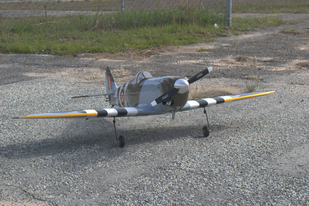

I built one of these a little over a year ago. I'll post some pics as soon as I can find them. Unfortunately, I didn't document the build, just the finished product.
Mine has a Saito .80 upfront with a 13x6 prop.
This is what I remember from the build -
[ul][*] The included push rods and other hardware were junk. Before I decided to scrap the hardware I actually had one pushrod shatter when I tried to bend it. The only bit of the original hardware that I used was the split-elevator joiner, everything else went in the trash. Including the nylon wing bolts.[*] The skin of the wing section around the holes for the wing bolts was very weak. I thought the bolts would just pull right through the wing under load. I made a little plate from light plywood to help spread the load over a bigger area. I also used better nylon bolts (the 1/4" socket head cap screws from RTL Fasteners with large nylon washers.)[*] I used the included engine mount at first. However, after about 6 flights I noticed it was starting to crack. It was replaced with a Saito aluminum mount.
[/ul]
I really do like this plane. I flys great, with only one bad habit - on takeoff it gets airborne without enough airspeed to really fly, then it wants to stall. Most of my takeoffs have been a quick jump to 20ft, a stalling dive to just inches off the ground, and then a real climb out.

Old 01-22-2010 | 12:13 AM
Joined: Jan 2005
Posts: 40
From: Sugar Land, TX
I just got through reading and looking at your photos. The plane looks GREAT, good job on putting it together. Thank you so much !!

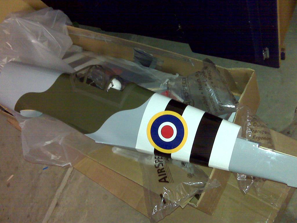

Old 02-01-2010 | 06:51 PM
My Feedback: (12)
Joined: Jun 2005
Posts: 326
From: Bakersfield, CA

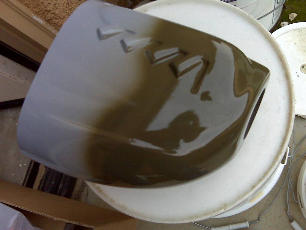

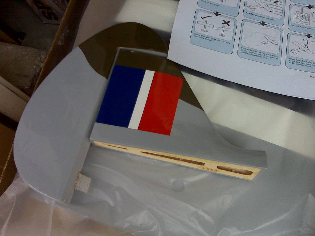

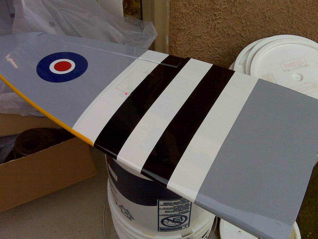

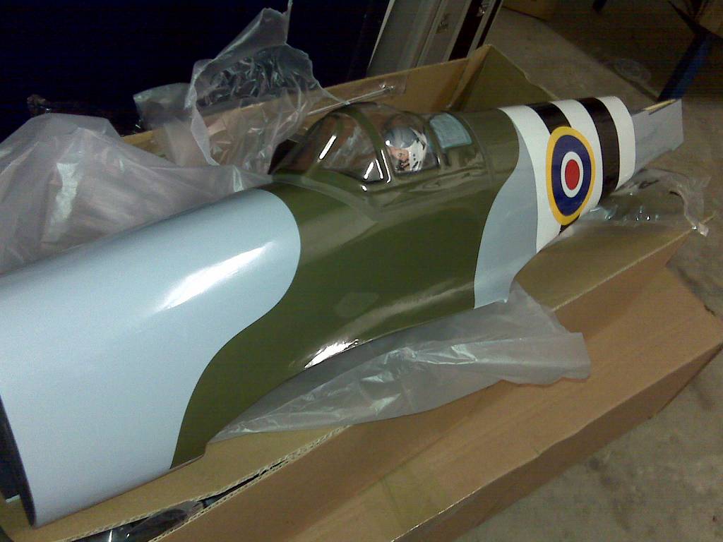

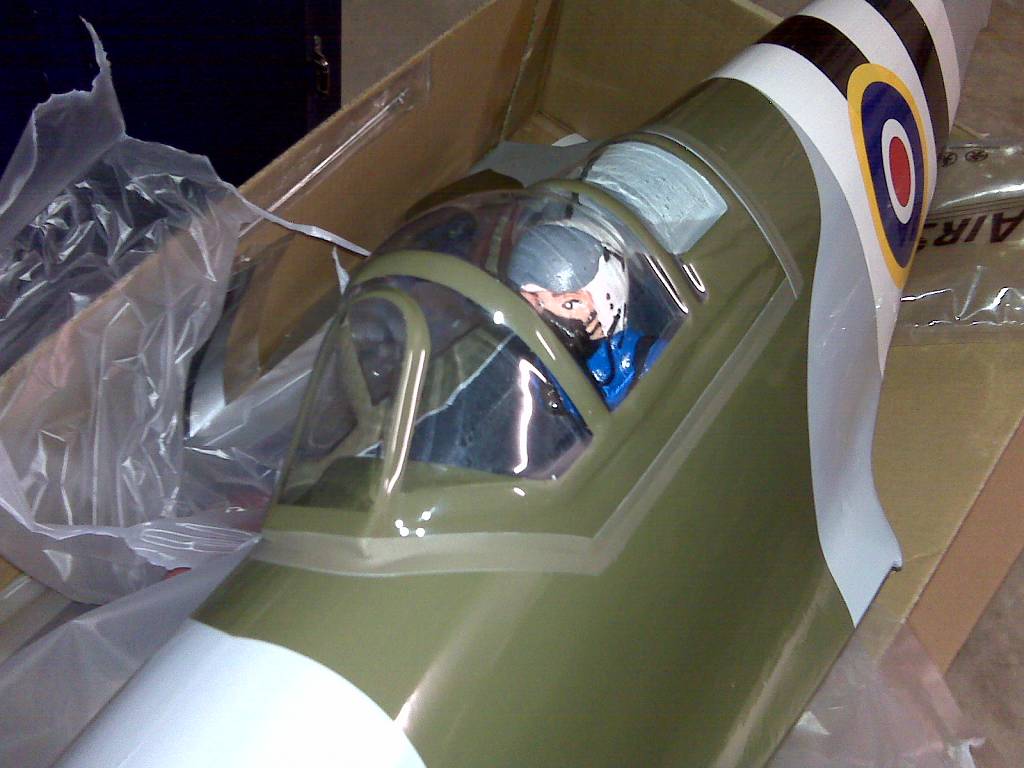

I just got mine in today. I haven't dug into the box too far yet but i'm impressed with what I've seen so far. Very minimal wrinkling on the orocote. The canopy is already attached to the fuse so no glue mess there! Retracts need to be installed so that would have been nice if they were already done but not a big deal. I might spray some Top Flite flat clear coat on it to give it the rustic look but then again she looks pretty as is. The bad things is the pilot they put in there. Why did they put that one in there? Come on Phoenix!!!

Old 02-02-2010 | 12:23 AM
Joined: Jan 2005
Posts: 40
Great photos,thanks for them. I notice on the photo of the wind it looks as if it has a tear in the covering or
maybe some damage on the tip. Would you tell me about this. Also you are right in saying come on Phoenix
about the pilot they put in the plane!! Thanks for the information and photos. I am waiting for my plane to
come in sometime this week.
Wingbox
