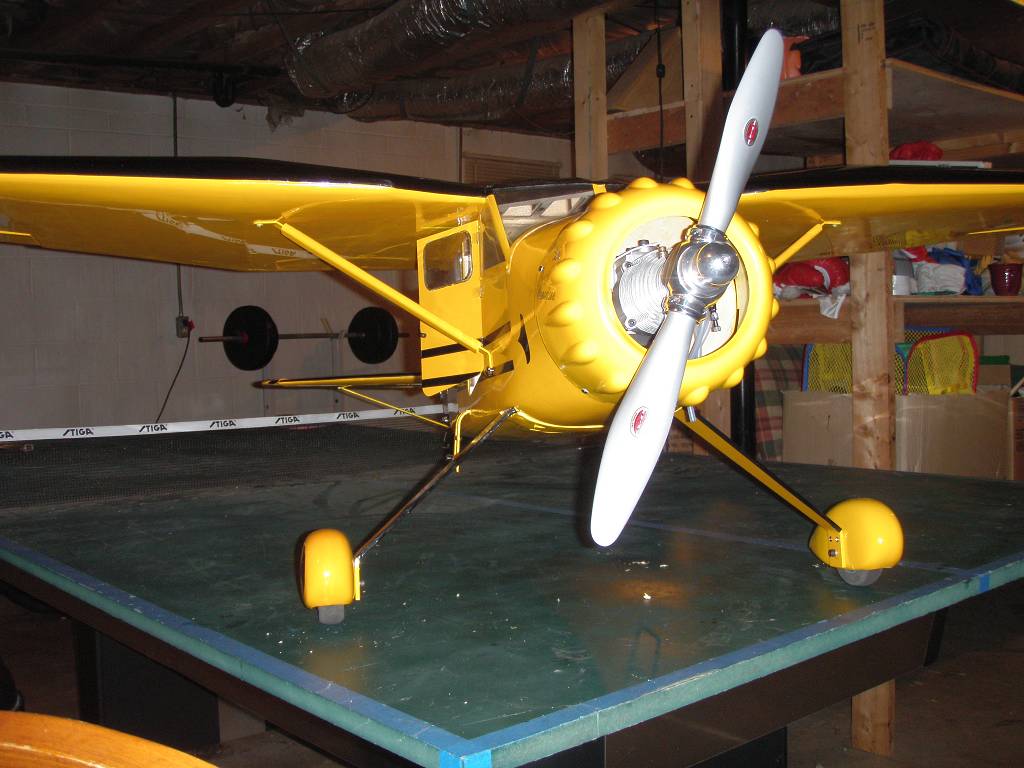

I see a lot of yellow in that work shop!! Kind of looks like mine. Mine did not come with a belly cover for the gear so I asked Valley View to tell the manufacturer to make one. I made mine out of block balsa finished and painted. I was worried about exhaust fuel getting in there but yours is gas so it shouldn't be a big deal

Hi there insyt21st !
That's one fine looking plane ! Hey, i'm wondering about that prop and prop hub ?? Tell us about it please. Also, is that a RCV 120 sp lurking in the cowling ?
I have one of the engines lying around and this is one beautiful plane..........Where do I get that COOL hub and prop ???
Thanks, Don

Thanks mrwad. Now you got my ego flowing!!. The prop and hub are from Solo GAP. They arent cheap but I could not resist. They were meant for each other. Mines an 18 in with 16 in of pitch dialed in. The RCV loves this prop and this is the best pitch combination that ive tried. It really tugs it around good. Plenty of reserve power.http://www.soloprops.com/

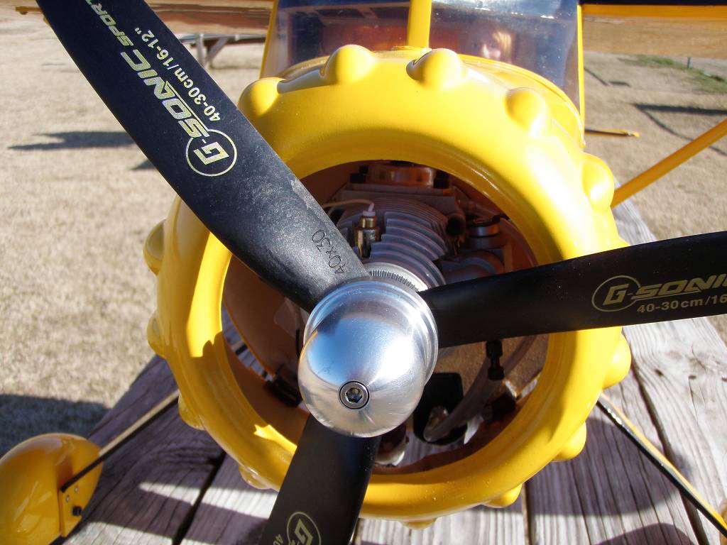

Another good option if your going with the RCV is the Graupner G-Sonic 16/12 three blade. It has just about the same performance just not quite the nostalgia. You may need it cause there is a wait period for the SOLO Prop but its worth it

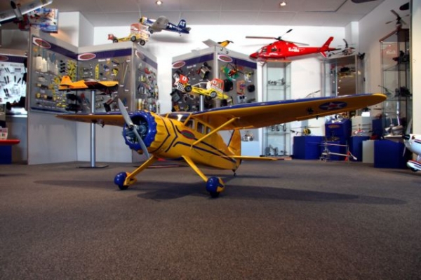

  #45
john neilson's Avatar
Joined: Jun 2003
Posts: 204
From: phoenix, AZ
Default RE: Valley View MONOCULP (am I the only one)
Well Bob, I think we both have good taste! A bit too busy for me. My likes would be Orange/Red with Black scallops but I can live with the Yellow scheme. That is a Monoculp but where is it? My guess is a picture from China. This company seems to build alot of the IMAC/Pattern type based on their website. The construction appears to be superb.

Old 05-05-2010 | 08:16 AM
  #46
Joined: Apr 2009
Posts: 227
From: asheboro, NC
Hey John. Jamara in Europe carrys this one. The craftmanship of the Monoculp is easily on par with Aeroworks and so is the hardware. Just not the price I did, however, reinforce the fire wall with epoxy due to the high vibration and torque of the RCV engine. Just to be safe even though its half inch haevy ply. The engineering is almost exclusivly ply wood, well fit, and heavily reinforced where it should be. You would not believe the construction of the wing carry thru. The bridge work is a work of engineering art!!! You can tell that a lot of design and test went into this one.
