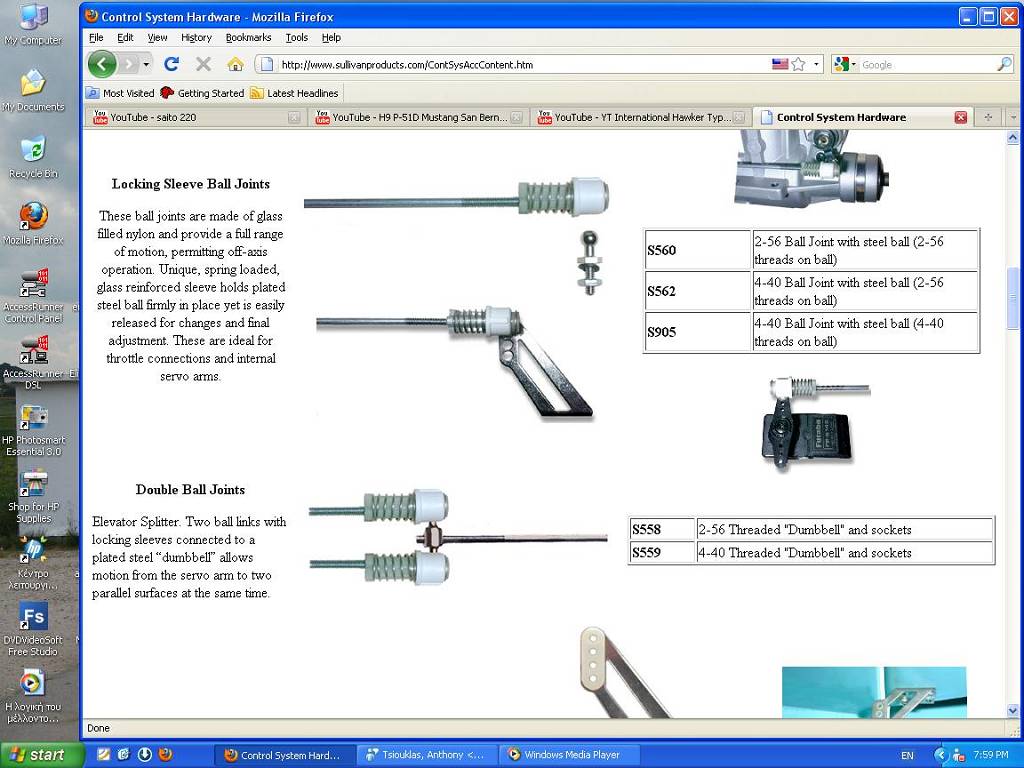

Guys,
my BlackHorse P-36A Hawk uses two elevator halves so that you must use two different servos for each half.
I came up with this splitter,
but really don't know how this works.
Here :
http://www3.towerhobbies.com/cgi-bin...?&I=LXFV37&P=7

ORIGINAL: Kostas1
Here's how:

Minnflyer thank you very much!
I have also JUST found this from their site :

Kosta, I have this plane and they provide a chrome plated brass connector to tie all three control wires together and it works quite well. The manual shows how this all works.

I dont know what your internal pluming looks like , but I have made my own rods by taking two 4-40 rods incerted into a carbon fiber rod then glued with JBweld .
The two 4-40 end exist out the back of the plane , the single carbon rod is run to the servo and another 4-40 rod is added with a clevis attched to the servo.
For interal smooth support I run a plastic white tube over the carbon fiber rod so the carbob pushrod can slide and be supported inside the fuse .
This give me one servo , a rock solid set up and smooth internal support

Yes I will try to dig up the actual pictures that I took. I will also try to explane it again .Dubro makes really nice carbon fiber rods . One of the ones they make has two holes in one end for a Y application to the elevators . The opposite end has one hold for one push rod to the servo .
It will show you to add the two medal push rods into the end with two holes . You then add the Jbweld or expoxy to secure them all in place . You add a single rod in the end to the servo.
The end with a Y appearance (two pushrods coming out of one connection ) this end splips out the holes in the rear of the fuse , then you connect the ends of the Y pushrod to ecah elevator horn (and adjust them to even )
You connect the single end inside the fuse to the servo like any other pushrod
