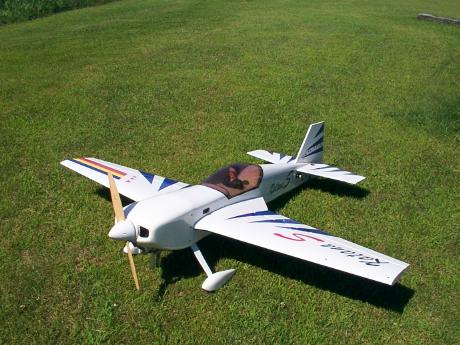

Here's a pic of my Katana that I got earlier this year. It's currently powered by a G-26 and weighs in at 12 lbs dry. I'm using Hitec 605's for the ailerons and elevators and a 625 with a pull pull system on the rudder. It flies great with this combo.

Wingman, how's the vertical? Will it hover? Is your g-26 stock? Man, that's a great looking plane! A $300 gas engine (g-26) would make it even better. Did you have to add any weight? Thanks for the info!
I originally had an RCS 180 installed and it was awesome. Unlimited vertical and it would hover effortlessly. At that time, I had the rudder servo in the tail along with the elevator servos and had to add about 8 oz of lead to the nose. In late September, the 180's ignition module went bad and had to send the engine in for repair. Not knowing how long it would be gone, I put a new G-26 with a Bennett type muffler. At that time, I also moved the rudder servo to the center fuse area. I was able to remove all the lead as a result. Due to the weather here (cold, windy) I have only a few flights with the new setup, but it seems to have nearly the same flight performance as the 180 (vertical is not as strong).

Thanks, Wingman. If it won't hover with the g-26, I guess I'll go with the 1.60 fx. You really have to spend some major bucks IMO to get great power to weight in a gasser.
Can you hop up a g-26 so it will hover this plane?
