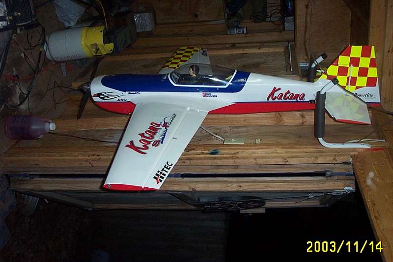

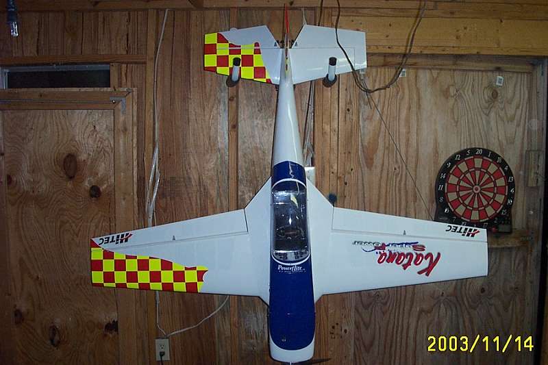

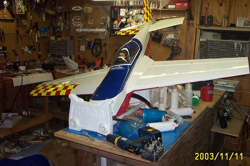

The Chief/GSP/Jett Hobbies Katana is the Same! They are made by CMP(China model Productions). I have built one they are great. I spent 6 months trying to deside between the creek katana and the GSP/Jett/Chief? and went with the GSP/Jett/Chief Katana from jett hobbies http://www.jet-hobbies.com
CMP is also releasing an Extra and Yak of this same size category, xcept they have incorporated a removable canopy/hatch for easier access. Both the Creek and the GSP/Jett/Chief Katanas are great planes. Here is a very imformative thread on the GSP/Jett/Chief. Hope this clears it up.
http://www.rcuniverse.com/forum/m_10..._1/key_/tm.htm
here is some pics of mine:
ID:	79314   Click image for larger version
ID:	79315   Click image for larger version
ID:	79316   Click image for larger version

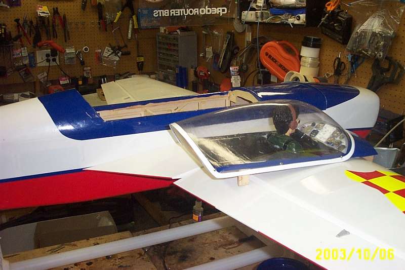

I built a removable canopy

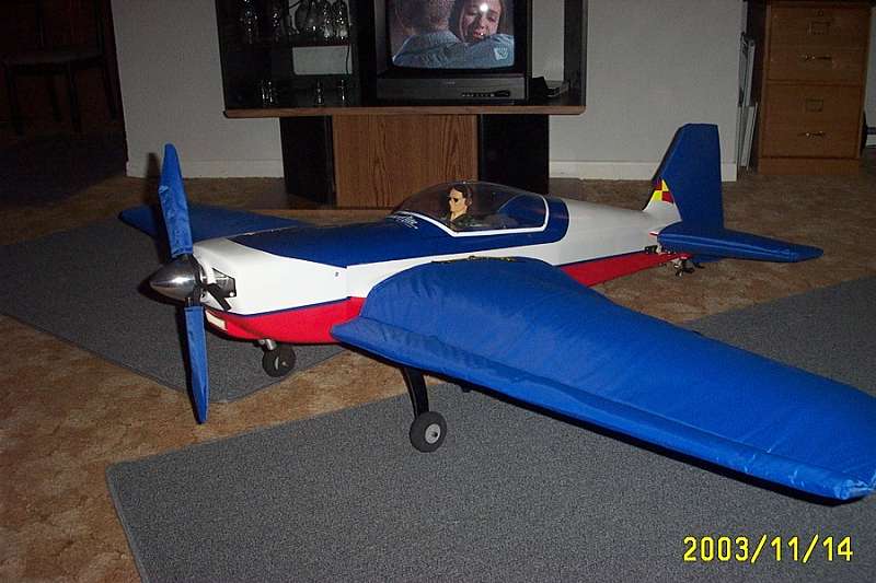

Dntmn, I love those wing bags! Did you use the 1.60 fx? Would I have to add tail weight to compensate for the weight of a Zenoa g-26? I understand that the shear web problem has been corrected on the CMP Katana. How's the covering? I was going to order the white Creek Katana yesterday, but their website was down, so I still have time to change my mind.
I notice Jet's Katana is $235 delivered, versus $200 @ GSP & Chief not delivered. Does the $35 added cost @ Jet offset all of the shipping?

Airplanenuts,
The wingbags are from wingbags.com they were special made for my Katana. Now that they have the pattern they are avalable from wingbags.com, ask for Matt.
I am using an OS 1.60fx with no added weight, Mezlik 18x6 CF Prop, Bisson Pitts Muffler, Perry Pump, I also bought CF Landing gear from http//:www.fiberlite.com
There is no lead added final dry weight is 10lbs 10oz
Jet hobbies are great I did a review for them a few months ago, great customer service
http://www.rcuniverse.com/magazine/a...article_id=193
Jet Has free shipping and a free scale pilot, so it works out to be about the same price.
I chose this katana over the creek because:
built up wing lighter than foam
airfoiled tail stronger than flat
I like the covering, it is not that transparent
that was too bad because creek also has great customer service
