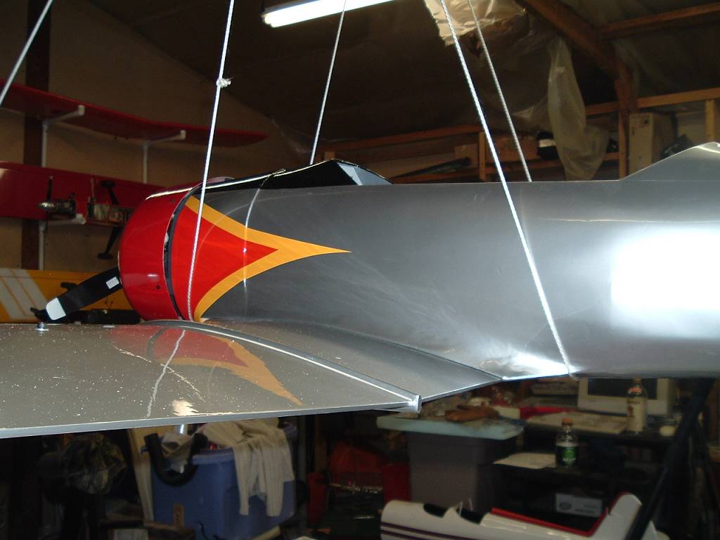

Let me introduce Daryl and Daryl. One of them is the pilot.

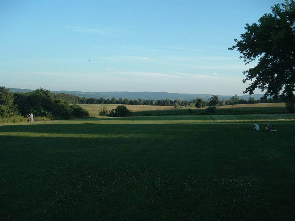

Here are a couple of shots of the runway, it's finally starting to fill in nicely.
I think I will put most of the stickers on this one, I don't usually put them on. I hope to fly it this week. Hobby people said that if I send back the spool valve, they will look at it for me, so for now, the flights will all be done with the gear down.

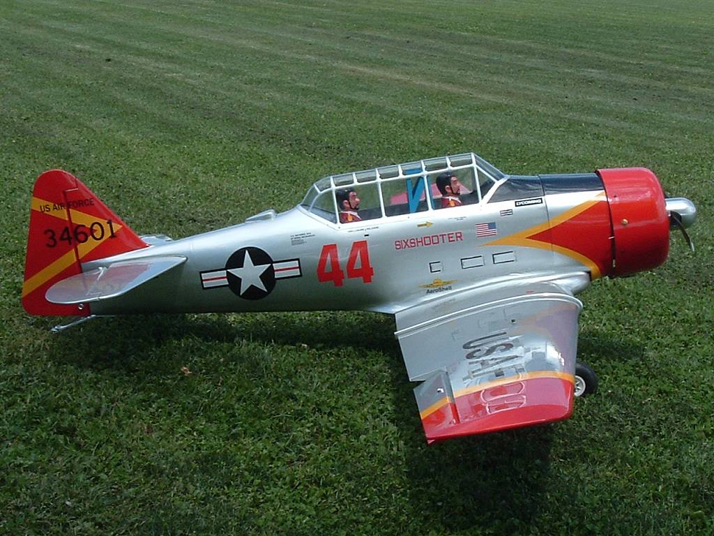

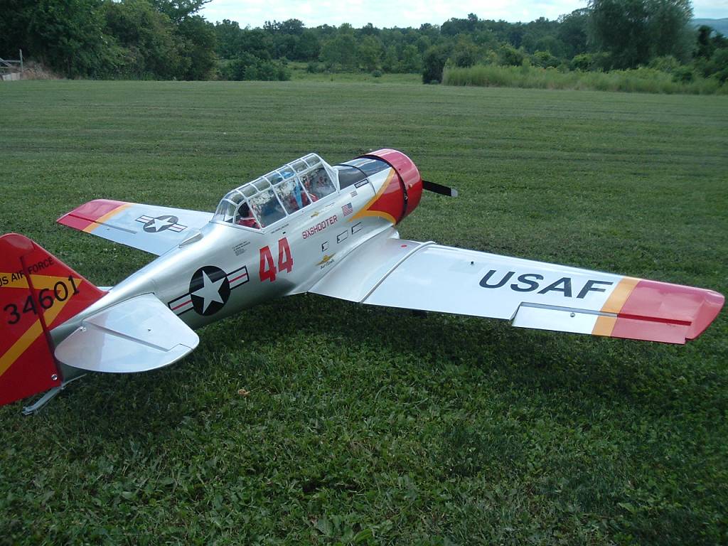

I put the stickers on. Everything but the #44, I got it half way on, and it just pulled itself on to itself, the sticky stuff just would not let go. Charged up the batteries, and now I have to find the loose end of the fuel line in the gas can. It has the filter on the end of it, and it came loose from the brass tube going through the cap, to the pump. I may fire it up tomorrow.
#60
I just started with the easiest to ID from the pictures in the manual. I went and did one side, then the other with the same sticker to try and maintain a little symmetry. I feel I have to something with the bottom of the wing, however....
I took the last numbers from the set, and scanned them in to my computer, printed them out at different sizes, and made a set on some red Ultracote for the fuse, and some in black, 25% larger, for the bottom of the wing. I had to add racing stripes, I will get pictures out maybe tomorrow, as it is raining and windy out right this minute...

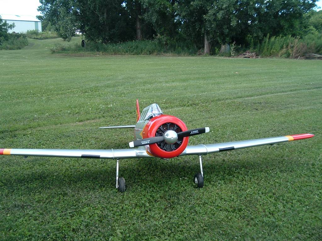

Close now, but too much wind for a maiden. Left gear collapsed during several taxi laps around the runway. The G26 may be too much for this airframe. I got it airborne a couple of times, but kept it an inch off the runway. This was at about 4 or 5 clicks of throttle. I only have a 16x8 MAS on it.
I might try to add expo to the throttle to keep it from jumping off the ground.

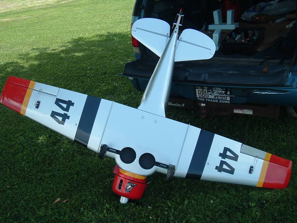

The gear didn't bend, which was what I thought when I saw it flop on it's side, the retract unlocked, and the gear collapsed / folded the direction it should if it were retracting. That makes the prop a little too low to the ground, and it quits spinning
Other than a couple glue joints missing glue, it was ok. You have to be somewhat careful handling it as the balsa used seems to me to be very soft. I guess the true test will come when I bank 90 at full throttle and yank back the stick. If the 2 halves don't separate, it will be ok!
If you look at the right side view, you can see the 3 hatches I made for the air fill, receiver switch, ignition switch.
.Other than a couple glue joints missing glue, it was ok. You have to be somewhat careful handling it as the balsa used seems to me to be very soft. I guess the true test will come when I bank 90 at full throttle and yank back the stick. If the 2 halves don't separate, it will be ok!

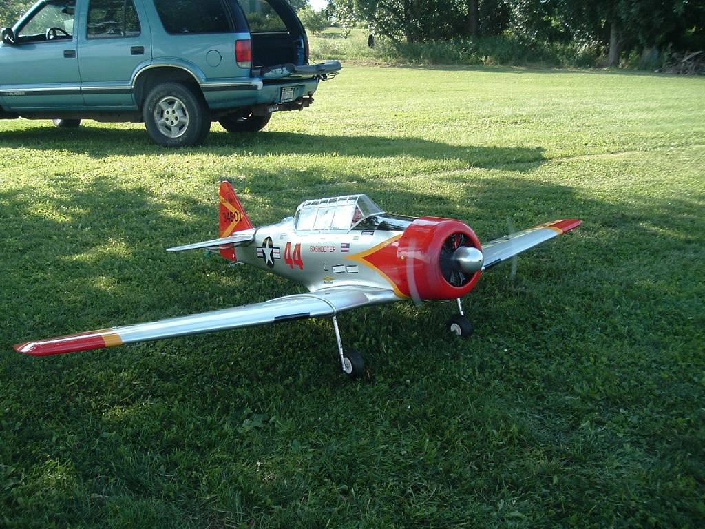

Where do you locate the soft balsa ?
I did encounter the same problem on my BH P-36A Hawk arround
the aileron servos on the wing
and arround the wing area where it meets the fuse and 2in on the inside...[
But on the maiden IT DID HOLD UP [X(]
You'd make it just fine , just keep your airspeed high enough !!!!

The soft balsa is on the skin. I can feel it give just picking the plane up, and I am a fairly careful person. I want to maiden it soon, but between weather and commitments, I can't do it yet. My boss just called me in 3 days early from vacation because they need extra help, and since he flies at my field, he knows how to get a hold of me....[&:].

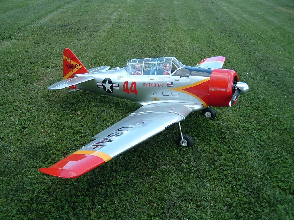

It flies well. I had to input a few clicks of left aileron, and a couple of clicks of up elevator. I had a 10 - 14 mph crosswind, and while it didn't affect the plane by grabbing a wing, it did push the tail with some authority. Although the wind did affect the flight, it seems like the plane is too light, and it gets blown around in the air similar to a lighter weight 60 size plane. About halfway through the first flight, I switched to high rates on elevator and aileron and was much happier with the control authority. I made a poor choice on the retracts, now one of the 3 set screws on each retract stripped when I had to stop while taxiing due to the landing gear twisting. They make it a little tough when I have nearly 1 inch of play from side to side, and about 3/4 inch from front to rear. And, although even when I had straightened out the twisted gear, and stripped the 2 screws, I decided to launch anyway if I could find a lull in the wind. Landing it without flaps, no big deal, it does take a little longer to bleed off speed, so after 2 go arounds, I got it to touch down a little over half way down the field. The G26 isn't overkill, but I wouldn't go any bigger either, as the airframe just seems light. Seems like a 120 4 stroke would work, but I may tend to go a little larger than that. Once I get a chance to fly it a little more, I will see what handles like with some basic aerobatics.
