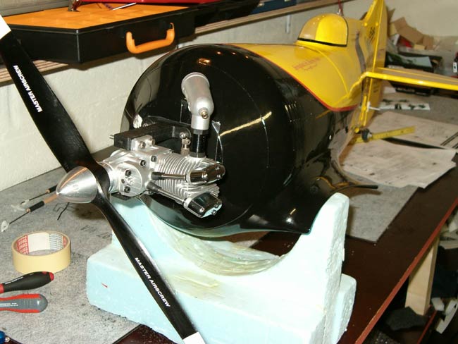

I got the Saito 72 and put it on the nose with a 14x6 prop.
Had to place the cylinderhead on left 'cause the the holes in the firewall were wrong for the engine mount and saito 72.
Guess there used to be 90 on it...
Hope to fly next week...

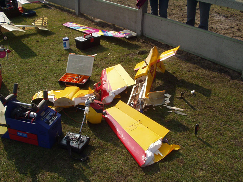

ps. Looks like you have a very nice Sukhoi (SIG?). I once too had a Sukhoi. Scratchbuild from scaled down real plans. (Did this not myself, bought it 2nd hand). OS 1.40RX with build in reso exhaust on it. On 3rd flight, i was just trimming the plane, i opened up the throttle flying level. The left wing was torn off. This was a 1 piece foam wing (no alu tube). Guess it just wasn't meant to be []
This was the result:
Gr Gaaaz

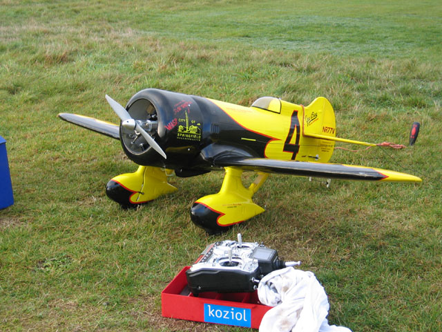

Old 02-26-2004 | 02:12 AM
autoguns's Avatar
Joined: Mar 2003
Posts: 831
From: Anchorage, AK
Default RE: Kyosho GeeBee Engine/prop?
Balance it very carefully ,nose heavy is a good thing with a gee bee z......Looked like a bug hittin the wind shield....The pic's don't look bad but the wing was toast and the fuse was split in several places....JW

Old 02-26-2004 | 01:15 PM
My Feedback: (25)
Joined: Aug 2002
Posts: 649
From: Dayton, NV
JW,What happened to cause this damage.
Old 02-26-2004 | 09:01 PM
autoguns's Avatar
Joined: Mar 2003
Posts: 831
From: Anchorage, AK
Gravity..........LOL. ...Tip stall on landing....It went inverted at about 25' no time to do much about it ...I think it was to close to being balanced on the CG ...I should have went with my gut and made it a little nose heavy......It died on the maiden flight.....[&o]...JW
Old 02-27-2004 | 11:50 AM
Posts: 304
From: st charles, MO,
JW,
Major bummer [&o] I feel your pain. I've had a Z in the box just waiting to get done for over 2 1/2 years now. I think I may get mine done this year....LOL Got a OS 71 4 stroker for it. I've known about the Z's balance issue since they first came out. I had a Byron R2 and balanced it nose heavy. She flew perfect. I expect the same from this little ARF.
