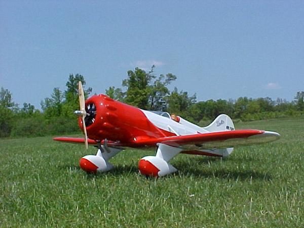

Default PAC Gee Bee Model "Y"
Have an 82" Pacific Aeromodel Gee Bee Y ARF. Weighs 17 lbs wet on 1175 square inches for wing loading of 33 oz/sq ft. It lands nicely, but it must be flown and flared to a 2-wheel touchdown. At 36 oz/sq ft it would only weigh a pound more. For a smaller aircraft this would probably mean higher relative flight and landing speeds, it's a RACER after all. The Model Y was intended to be a 2 place sport plane.
Just saw TLH101's post: That one has a MUCH better wing loading.
