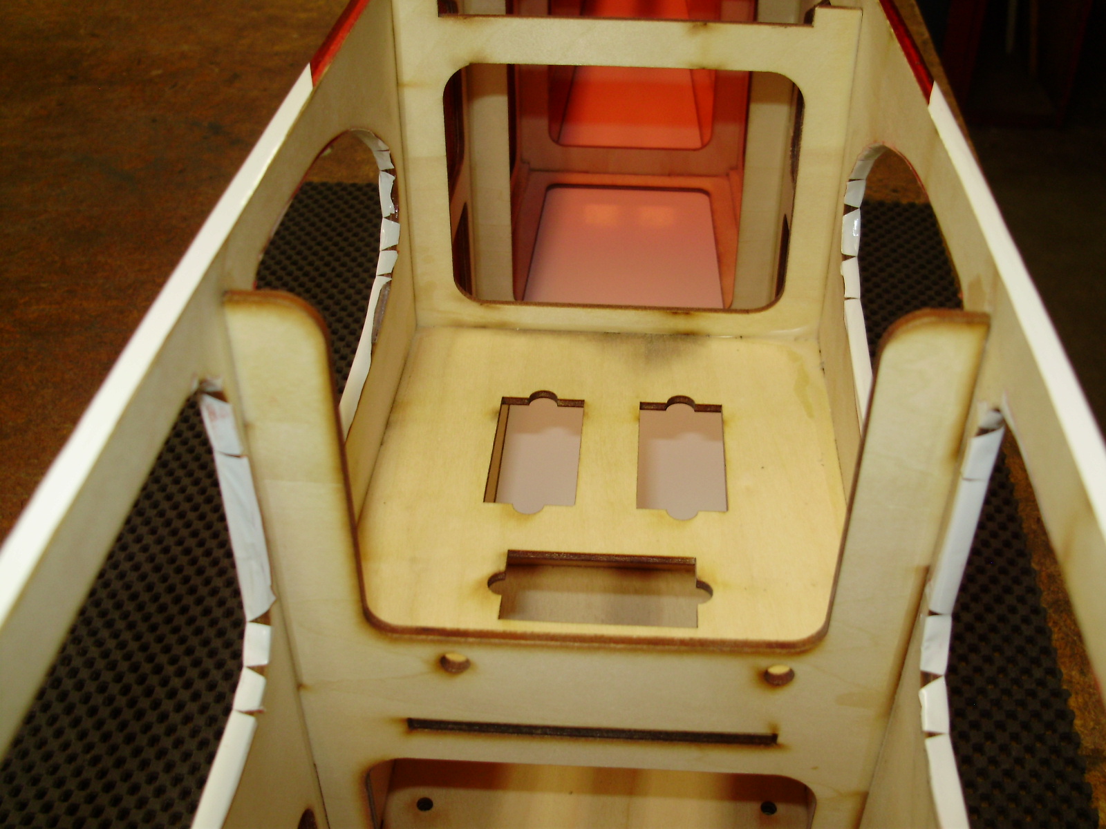

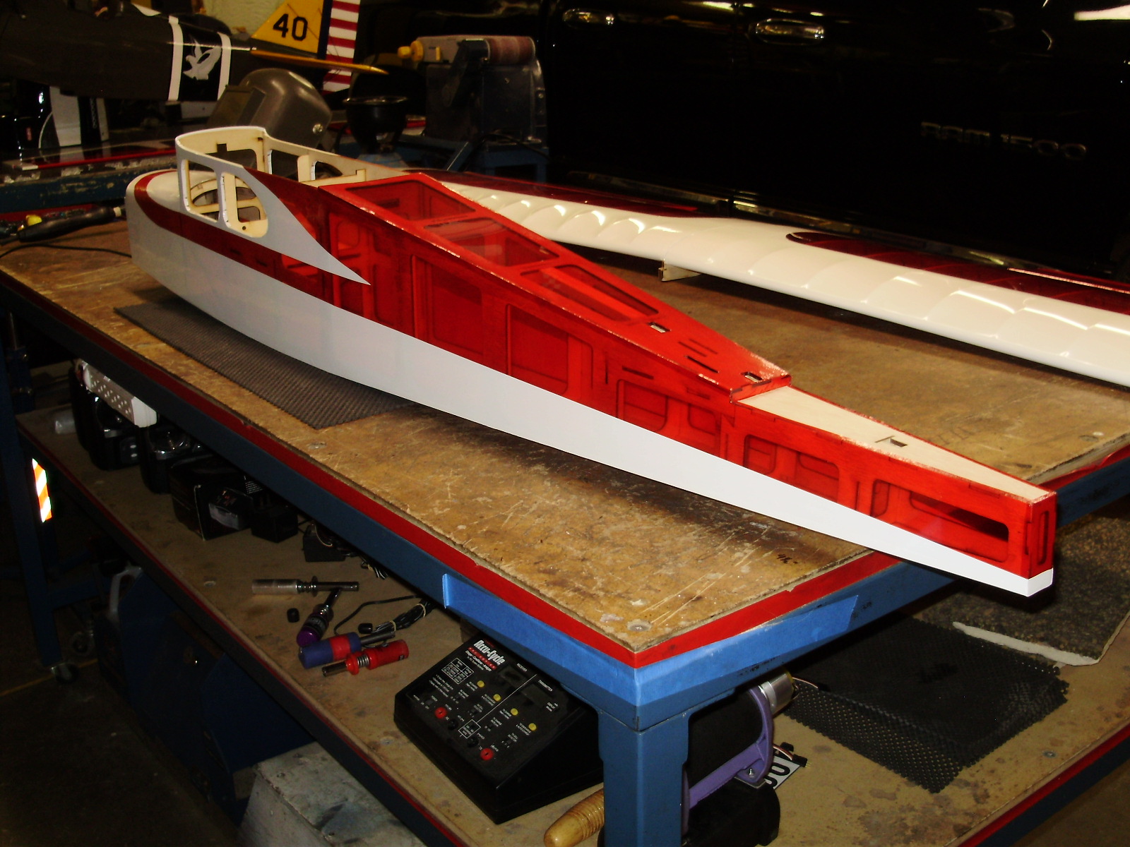

Well got some pics. Every thing on this bird seems to be ply, even the wing ribs, very solid plane. The manual that came with it is for the earlier version so only some thing will apply to this one. I like the fact that they left gluing the hinges to the end user, eliminates any doubts about them. No horns are attached which I like cause I use upgraded hardware anyways. The windshields are tinted, very happy with that. Didn't measure, but looks like about 2" of dihedral, VERY VERY happy with that !!
outlander: if you look at the manual it shows servos attaching to the hatch covers where as in this version the servos attach to the wing it self with no covers.
Might have to rethink about putting on my new Saito 62 and mabey jump it up to a 82. we'll see how the weight comes in.

Great shots! No question much stronger. Finally got thru to Nitro by phone, the guy screwed up the info but finally got it right (I think)? Nitro sure could use some help in business practices....answering the phone during business hours, letting customers know if they are closed during the Holidays and forget the "take it or leave it" attitude.[:@]

I already miss the aileron blocks and covers . The V2 is definitely heavier .
V1 Fus. 22.50 Wing 14.80 H. Stab 5.35 V. Stab 2.35
V2 Fus. 28.75 Wing 16.35 H. Stab 6.60 V. Stab 3.05
All weights are on a postal scale in ounces . Fuselage includes windows and ailerons for both .
The original SIG Kadet Senior is almost 10 ounces lighter just in these 4 pieces .
The original flies well with a wide variety of engines and weights . I hope the V2 flies as well .
