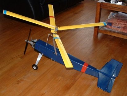

V-tails a bad idea ????? Nonsense
Here is my Whirling Dervish. It flew really well and was fully aerobatic. As you can see it has a v-tail.
I actually tried a normal tail as well but there wasn't that much to choose between them. If anything the conventional tail gave better stability in strong winds but the v-tail acted like a dihedral wing and gave a higher roll rate when used with dc roll on the head. Personally I like the look of a V-tail. If you are interested the internal V angle was 120 degrees. Pitch stability was the same for both types of tail.
Sean
Sean

Hi Spindizzy,
Congrats, on your success with V tails that have eluded the rest of us.
Could you supply more details of your Whirling Dervish design?
Bob Gardner
Bob Gardner

Spaced
With regard to the area of the V-tail my method of deciding how big to make it was not exactly 'scientific'. I simply ensured that when viewing the tail from the side, the area that was visible matched the visible area of the conventional fin. Same went for the horizontal stab when viewed from above. Needless to say the overal result of this is that the v-tail is physically larger than a standard tail. Were my new gyro having only a single rotor system I would be aiming for a disc loading of around 3.5 oz/sq.ft. With a two blade co-axial rotor do I half this figure ??
This loading figure is based on my other small gyros that always end up around 3.5 - 4 oz/sq.ft.
Rotor diameter will be 32" on my new design with power suplied from a Hornet .09 with a 7x4 prop.
Cheerio
Sean
