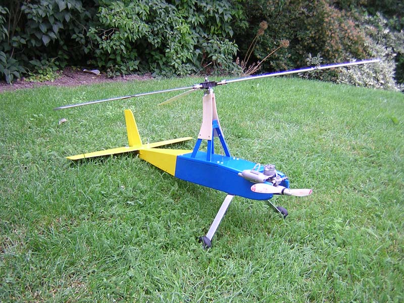

After a lot of crashes I had 5 successful flights with my autogyro today. And that is after having modified it with a higher pylon to improve the roll stability. I also had to decrease the angle of attack of the blades to make the rotor spin up quicker. And it worked.
However there is still a problem. It has good stability when rolled to the left. This means that I can roll it to initiate a left turn and it will keep the bank until I roll it back. But as soon as I roll it to the right it will bank heavily and spiral down. The only way to save it is to quickly straighten it up by giving left roll. So at present time right turns must be avoided.
I wonder what could be wrong. Could it be that the fin area is too small? Or do all autogyros behave like this?
The rotor has clockwise rotation.

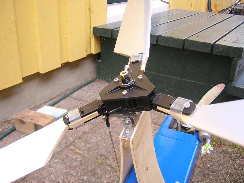

I had the possibility to make some further tests to day and managed to make some right hand turns but they had to be very wide otherwise the gyro tipped over. Quite different from the left hand turns which are very smooth and can be made very tight. To the left it turns almost like an airplane. To the right it spirals down.
The autogiro has some kind of a delta hub. It is molded in plastic and produced by the company PeAs Rotorblad. They also produce the kit I built the gyro from. The blades can flap up and down totally about 11 degrees. They flap around an axis that is perpendicular to the length axis of the blade. I have seen hubs that have this axis angled forward (difficult to describe). Maybe this would be an improvement. On the other hand it is curious that the stability can be so completely different for left and right turns. Possibly it is an indication that the stability is marginal.
I attach some pictures.

Default RE: Successful flights
By looking at your bottom picture it appears your blades are mounted upside down. This may be causing the right turn problem. Most gyros rotors spin counter clock-wise.
No the blades are mounted the right way as this rotor is designed for clock-wise rotation. I have also seen that most autogyros seem to have anticlockwise rotors but it should not influence the stability. Or does it?

Hi Peso,
From your pics, it appears that your lateral sevo rod is pulling when turning left & pushing when turning right.
Could your pushrod be bending or buckling in that problematic right turn? You might want to try a stiffer push rod.

Stability>lateral area is important. You have an "open" work pylon? Try
enclosing the thing so that area wise it would be same as a"solid" pylon
Not mentioned is size and power of your gyro?
