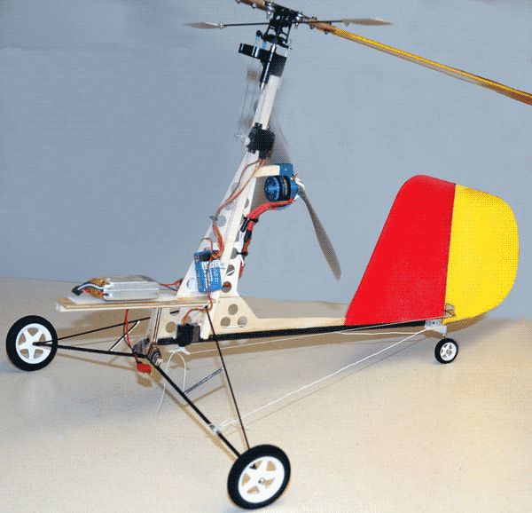

Here's BEGI-2. 14.9 ounces RTF.
Himaxx 2812-850, APC 10x4.7 SF, Phoenix 10, TP 1320 3S1P ProLites.
16" aerobalsa 1.5" blades, 3" solder in tip LE, a little positive twist in the blades.
Ground handling now acceptable, the key is very rigid main gear. Will make a change from the photo, the current second strut was just a quick hack to prove the idea.
Flight is execellent like the other BEGI. Adjusted a few angles including the engine thrust line. At half throttle you can pretty much fly with aileron and
elevator. Improved the rotor clearance as well. I think the couple rudder strikes I had on the other one are long gone.
This one is worth building. I copied the parts as I went along so plans should not be hard. If you want to build it's mostly G3PO parts. The only odd sized wood parts are two pieces of 10mm x 5mm spruce. I cut down 1/2 by 1/4 on the table saw.
I purposely designed the main chassis to be laser cut, perhaps the kit of this one will be a little easier to build in terms of chassis.
I will post when I have the drawings available.

It looks really nice [8D]
I can't wait to order a kit
Have you got a video of it flying ???
What is the distance between the trustline and the CoG ?

No video yet. My videographer is still at school.
CG is one inch below the thrustline, but this is
just happenstance, not design.
I have read the theories about this criteria but don't completely
agree with them. In a steady state non-accelerating condition
the mass of the aircraft is not generating any forces in
the longitudonal direction. (f=ma, if a = 0, f = 0)
Further, the explanations I have seen ignore the drag vector which
is significant. I agree that when accelerating and decelerating the
cg/thrustline generate a couple, but the drag must be incorporated
into the analysis as well.
