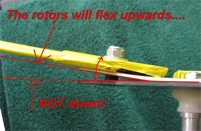

Hey guys...sorry I hit the forum late. Glad to see that Kriegsmacht has been steered nt the right direction. For a 40 size fuselage....the plate from MJP carbon should do the trick. MJP Carbon also make the same plate but wil .400 dia. holes to accomadate the mounting bolts for the rotors. this acts as a base plate. This will allow the rotor to flex up as it passes over the front of the aircraft, but it keeps the rotors from slapping down...... like during a rough landing. Go to the MJP Carbon site and write to Mark and tell him you wan the rotor plate of G-10 fiber glass and the bottom support plate of 1 mm Carbon fiber. To this day....I dont know why he is not showing the bottom CF plate on the web site. I hope to fix this problem soon.

I plan to order the fiberglass plate with the blade mounting holes as you suggested, but I am a bit confused about the "bottom support plate"
Isn't the fiberglass plate mounted to a hub, the blades are mounted to the plate and thats the whole system? Or am I off base again?

These are from my DAG-1 build guide CD. The black plate is the Carbon fiber. This is the Carbon fiber bottom plate that keeps the rotors from flopping down too far. The rotor plate is made of G-10 fiber glass and is flexible.
Dave

Ahh yes I see clearly. In flight they won't be touching the base plate anyway, so they are free to drop down a hair or flex up a hair depending on thier individual needs, however at no time should they droop or slap any lower than when in contact with the base plate. Like you said, in a bumpy landing. Should help to prevent the blades from ever striking the tail as well?
