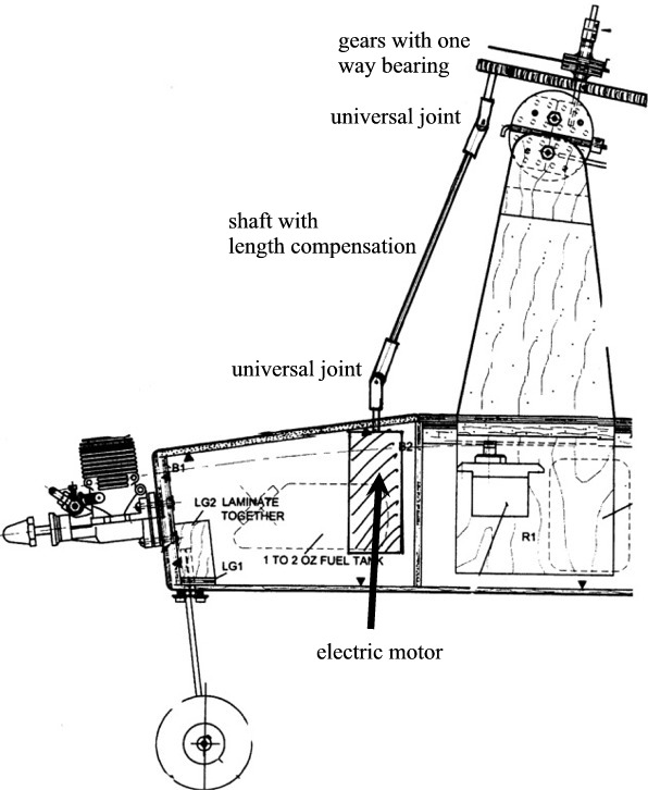

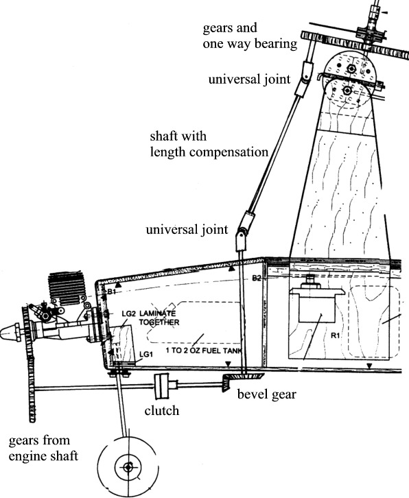

I’ve got the idea to add a prerotator to my DC autogyro (see pics) to achieve a very short take off running even in no wind conditions.
In my opinion, there are two solutions:
1) A mechanical prerotator (see pics)
A servo controlled clutch is driven from the engine shaft by reduction gears. Bevel gears lead the motion upwards. Two universal joint couple the bevel gears with the reduction gears in the rotor head by a length compensating shaft. The rotor axis is driven by a one way bearing.
2) An electric prerotator (see pics)
An electric motor is coupled by two universal joints and a length compensating shaft to the reduction gears in the rotor head.
What do you think of these ideas? Which one is more realistic?
Problems: What kind of clutch to use? Reduction ratio? What electric motor to use? Change the receiver battery to lipoly battery (7,2 V) to drive the motor and reduce the voltage to 5 V for the receiver?

I went the simple route and just put the electric motor right on the head.
After going through all the options with clutch, gears, extra servo for the clutch,
etc., the lightest solution turned out to be a small brushed motor up top.
Lots of current gyrocopters have the pre-rotator on the head, generally a hydraulic
motor where the pump is on the main motor.
mickey

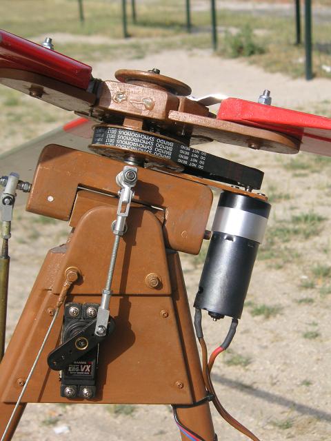

Check this pic out!
Wahid

Hi Wahid,
are you using a freewheel head or is the motor driven when not under power?
Regards.

This pre-rotator is my mine. It was submitted by Emilio Cabezas. See the link below:
http://www.rcuniverse.com/forum/m_47...tm.htm#4744190

Ah! eye fort eyed ceen the foto befour. [sm=wink_smile.gif]
I contacted Emilio concerning the unit but he couldn't help as as it's not his contraption. But out of curiosity, if there is no freewheel wouldn't the friction be too much for the rotor? Or does one have to provide a larger rotor to overcome the problem?
Regards. Karl.

I am also interested about the free wheel issue? The electric motor slows the rotor down without free wheel.
I have sometimes thought a brake for the rotor would be more useful than prerotator. After you land in windy conditions, rotating rotor is vulnerable if the gyro tips over by the wind.

of course there must be fitted a freewheel between the upper gear and the rotor axis! But this was not my question.
What do you think of the mechanic drive from the ic engine?
Complicated, heavy, small benetifs for model airplanes but very cool
We must keep in mind that most of us do these (autogyros) because we love to do strange and interesting mechanical things. Not because there would be much use of it in our life

I would totally forget the idea of using universal joints. Not only they will add considerable weight, but a lot of complexity to get them to operate right and they are quite sensitive. Big gyros behave differently (that's why 2 blades work fine, but on models they are tricky to trim), not because different laws apply to them, but because those laws depend on the size of the object.
And, after all, autogiros are about simplicity. I also believe that the simplest solution is often the best one.
The engine starter is the best aproach IMHO. If you can find a good combination of motor and reduction, which is the "difficult" part, and mount it right on the rotor (the pic shows it very clearly). On top of that, a brushed motor and gears won't cost you much.
