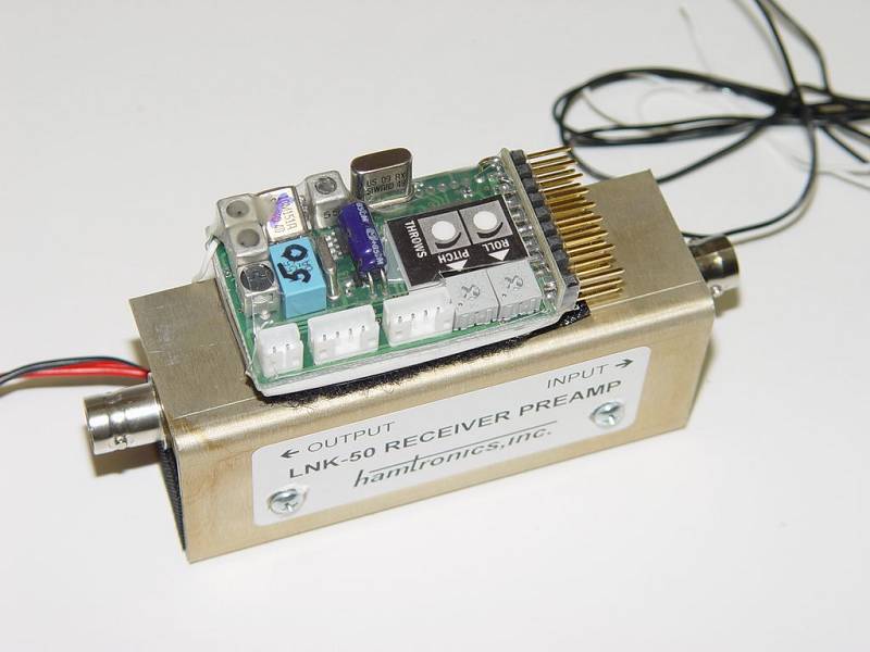

I had problems with the range on my FMA FS8 recievers. Their range limit seems to be 3/4 mile in the air compared to several miles for JR and Futaba recievers[:@] I have two FS8 units, so I know its not just a defective reciever... I have also read some other threads about limited range of the FS8 units
. After some pretty extensive testing, I found that the range problem can be solved on the FS8 by adding a reciever preamp . The FS8 reciever just is not sensitive enough by itself and the range was much less than my JR reciever. After putting this preamp on my FS8 reciever (pictured below), the range was increased to almost exactly match what I could get with my JR.
Thinking that might get even more range from my JR, I put the same preamp on my JR reciever but that did increase its range at all. It appears that the JR reciever is sensitive enough already and the preamp just does not help it...
The only bad part to this whole thing is that the preamp requires 12 volts and is rather large [X(]... So that makes it hard to use this in most RC planes. Any suggestions on how I can increase the sensitivity of these FS8 receivers ??? Attached is a picture of my Preamp Solution....

The FS8 has been air tested to over 5 miles in the OUTLAW system and we demoed 3 miles ground-to-ground on Wednesday with a Futaba 9CAP and 800 mw output. The range of FS8 is very far beyond visual range at 72 MHz.
One possibility is a transmitter that is probably way off frequency. It may work with your JR radio because it is broadband enough to tolerate the error.
We could test your FS8 receivers for proper tuning or even check your transmitter calibration, if you like. Please call Tech. Support at 301-668-4280.

I am fortunate to live in the area where FMA is located, and I drove up to their Facility at Frederick Mayrland to take them up on thier offer to tune my transmitter for free. I got there and their tech guy Howard was very friendly and started testing my transmitter right away. It turns out that my transmitter was quite a ways off frequency and over modulated [:@] Howard carefully adjusted my radio to the point that it was dead on frequency and modulatoin. While I was there Howard also checked and tweaked both of my FS8 recievers for optimum performance and also gave me lots of good advice.. For example to use an opto isolator on my large plane where ALL the servo leads are over 48 inches [X(]
The transmitter tuning fixed the problem. Today I collapsed the transmitter antenna while the plane was 600 feet in the air (measured) , and while it would go into fiailsafe intermittently, I had full control of the airplane and could fly around just fine
. With the antenna up, my previous range issues were gone
The FS8 reciever gave me better performance and rejection of the interference from my onboard video transmitter than my JR reciever does.
I also bought the flight recorder module while I was there, and its really neat to be able to see exactly what was going on with todays tests. The FS8 reciever has so many neat features that I will eventually replace ALL my recievers with FS8 units. There are very few companies that would help out thier customers to the extent that FMA does, which is just icing on the cake
