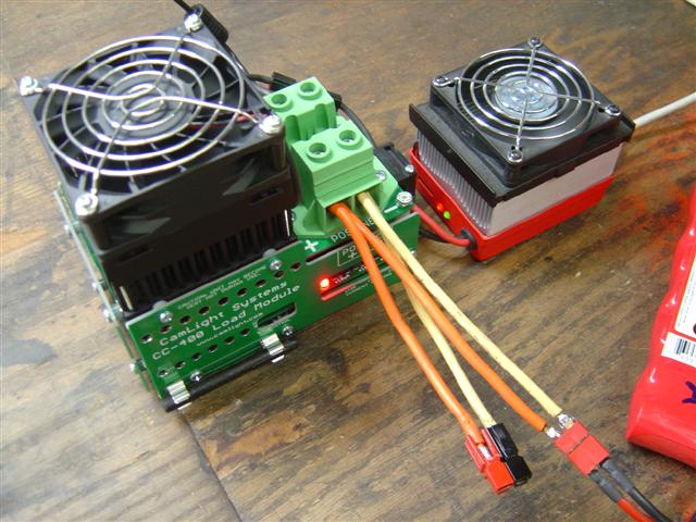

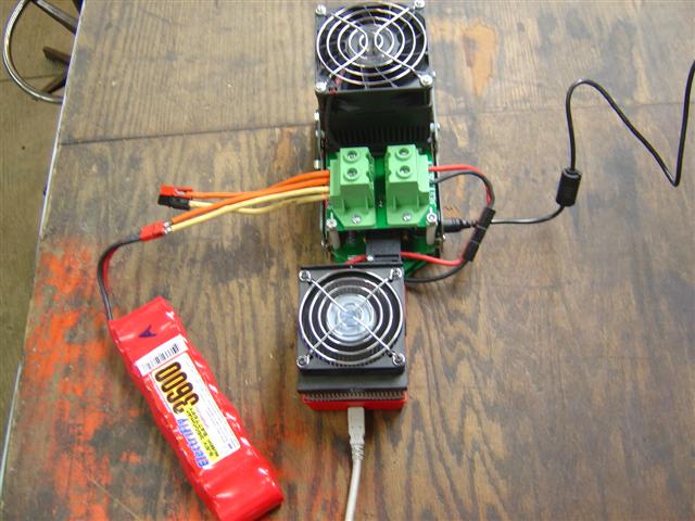

3 Pics of the CC-400 from John at Camlight , being controlled by the cba . The cc-400 is also programmable to do burst current testing AND a neat "throttling" option where one can program the end point current and use your Transmitter manally. I've not played with either one of those functions yet, just the constant current. The constant current is the best and easiest way to compare packs fairly.

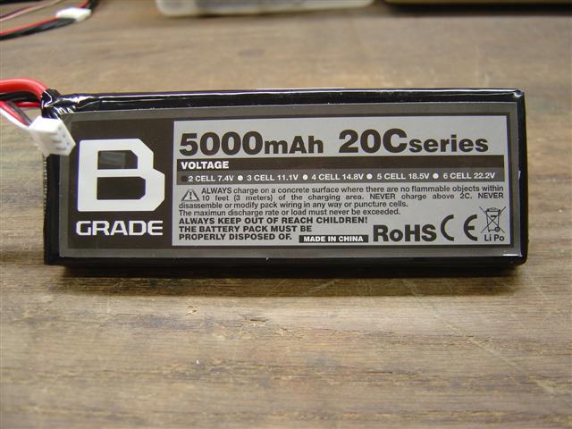

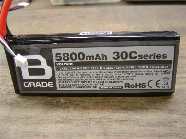

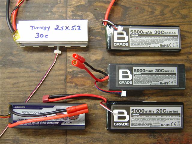

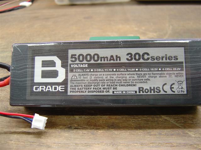

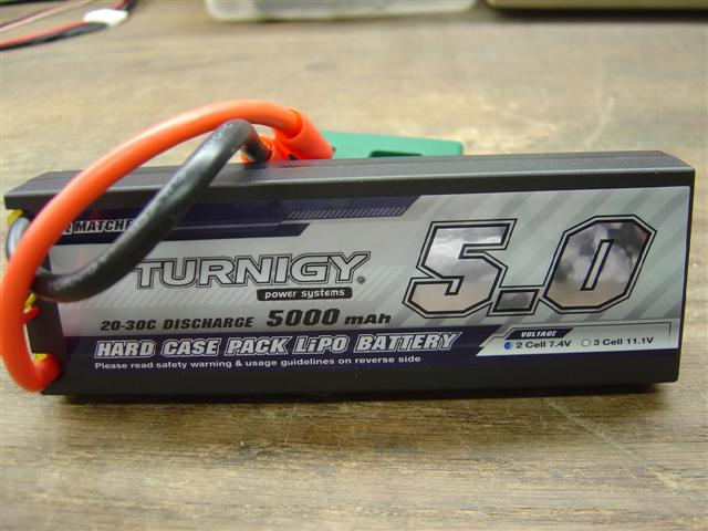

2s x 5000 hardpacks
Old 04-29-2011 | 02:22 PM
My Feedback: (325)
Joined: Mar 2003
Posts: 14,857
From: LaGrange, OH
Default RE: CBA graphs

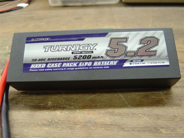

The above link is hard and soft packs and will include these packs soon.

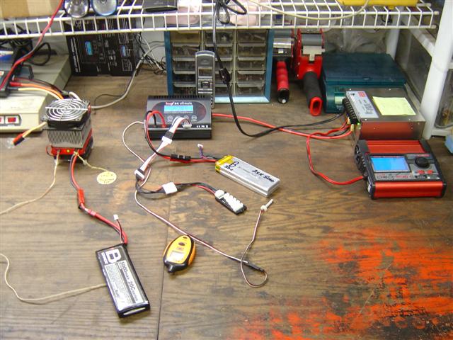

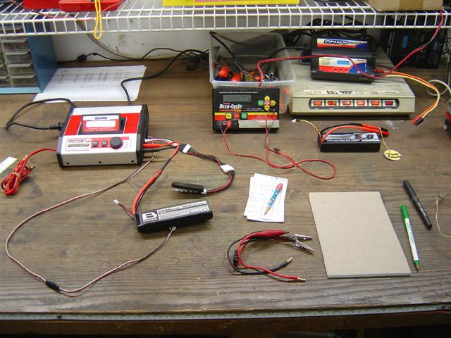

Some pics of today's set-up doing 5 packs at 5-50 amps
Two 8 amp chargers on left side Triton 2 EQ and the Onyx 235 (both run on AC power)
Hobbico elite to quickly manually balance the cells. Triton EQ is used to check cell balance quickly.
Two 10 amp chargers on the right side TC 1030 and the SkyRc Ultimate.
CBA in the middle with a CC400 load when needed.
