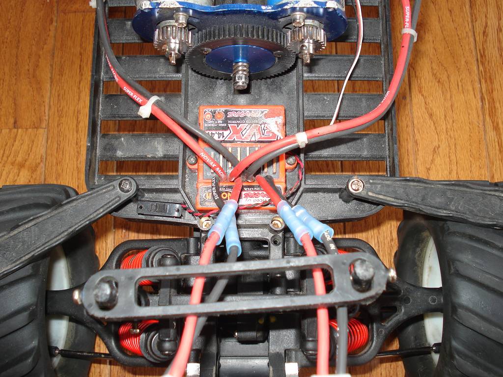

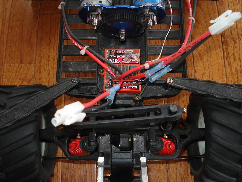

I bought my son a used E-maxx. I was converting the battery connections from Anderson to Tamiya. I charged up his new Venom 3000's and plugged the battery in and it sparked and the battery almost immediately started to get very warm. It only does that on one of the battery plug on the right. I don't get any reaction when I plug just one battery in and am afraid I have burned the ESC. Just a little history, earlier I bought a solder gun and was trying to solder the new tamiya wire/plug to the existing wire. Once I realized I didn't have the skill to do it properly I purchased some connectors that you can just crimp. Please help. I don't know if I messed up the esc while soldering or if it could be something else.

Here are some pictures of my son's truck. Everything looks straight to me.

Old 08-29-2009 | 01:51 PM
Joined: Aug 2007
Posts: 7,441
From: Edmonton, AB, CANADA
Default RE: Newbie problem
I just looked over the manual and it looks like you have the positive battery terminals going to the wrong batteries. I'm not sure whether that makes a difference or not.

My Feedback: (325)
Joined: Mar 2003
Posts: 14,857
From: LaGrange, OH
That's a great pic. It shows the two lower wires + and - going to two different packs because they are common. You're right, the two + can be switched OR the two - can be switched.

Joined: Dec 2005
Posts: 31
From: Fredericksburg, VA
Druss and Guver, thanks for your advise. I looked at your link and fixed my son's truck accordingly. Tested the truck outside, checked battery temps a couple times during his short runs and everything worked great. I appreciate everyones help, my son loves his truck now.
