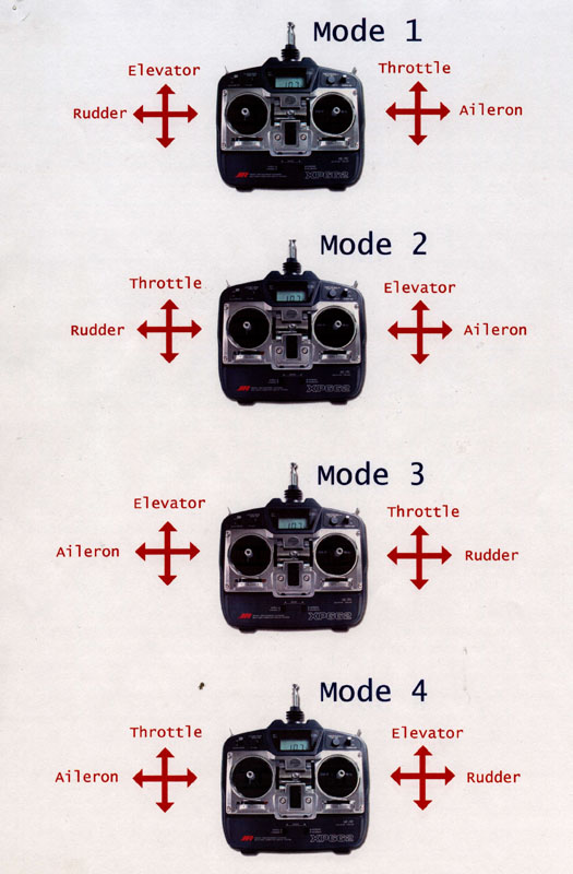

Some of the previous posts have wrong info in them so be careful.
Most of the US files Mode 2. This has the right stick set up the same as a real aeroplane's joystick -
Right Stick Mode 2 - Aileron (left to right) and Elevator (back and forward).
Left Stick Mode 2 - Rudder (left to right) and Throttle (back and forward).
My club mostly flies Mode 2 but this is unusual in Australia. I fly Mode 1 as I learned in another club.
Left Stick Mode 1 - Rudder (left to right) and Elevator (back and forward)
Right Stick Mode 1 - Aileron (left to right) and Throttle (back and forward).
The normal elevator stick operation is so that if you want to give UP control, you move the stick towards the bottom of the radio though I have seen people fly the opposite way.
Also, Throttle is usually set up at minimum throttle at the bottom and maximum at the top but again I have heard of people who fly the opposite way.
To further confuse things there are Modes 3 and 4 which are mirror images of Modes 1 and 2 but I don't know which is which.
As Jaka I think said, if you only have rudder control and no ailerons, you use the aileron channel (right stick in both Mode 1 and Mode 2) for the rudder.
So to answer your question - for both Mode 1 and Mode 2, the ailerons are on the right stick.

Do the ailerons go on the left stick with the rudder control on the right stick of the TX?
On the right stick of the Tx (for the most used in USA Mode 2).

I'm going to open this back up because I didn't see this mentioned.
Of course someone can set up their radio any way they want, and you may find something you like better than the standard. But if you ever want to have someone test fly your plane, or if you want to fly someone else's plane, then you should go with the majority and keep it simple, go mode 2. Throttle/rudder left stick. Aileron/Elevator right stick.
And yes, with this set up, if you have a rudder only plane, you can just let the right stick control the rudder and you won't have to make any adjustments yourself..
