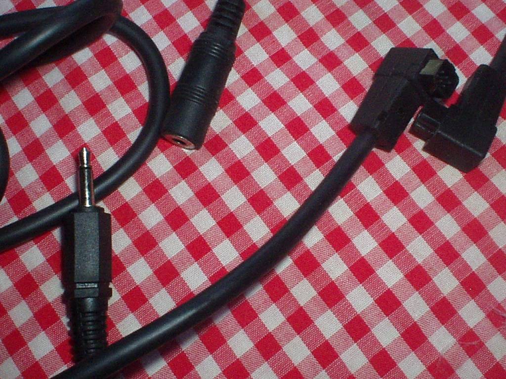

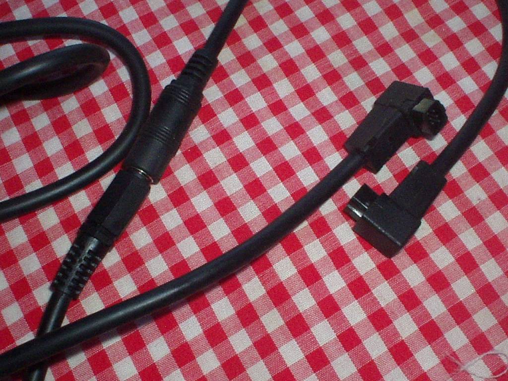

Will the battery lights on the t4yf com on when attached to the t6exap if every is working correctly.
If the trainer cord is not attached to the 6exap and the trainer switch is lifted will the sticks on the t6exap still control the airplane?
I think I am trying to trouble shoot why things are not working.
This is the cord
This is the cord
Posts: 4,987
From: Laurel, MD,
I don't know if the t4yf lights should come on, but I don't think they will.
If you don't have a battery in the t4yf, then the master has to provide power. I haven't seen futaba cords that had the phono jack in the middle that weren't from simulators, and I haven't see one work with Futaba gear like that. I could be wrong, but I think your problem is the cord.
If it's a power thing, then you might get it to work if you put a battery in the t4yf, leave the crystal out, and turn it on. Then try them two radios together.
Ok I got a new trainer cord today. When plugged in the lights on the T4yf light up and I have control with the trainer switch lifted on the 6exas.
