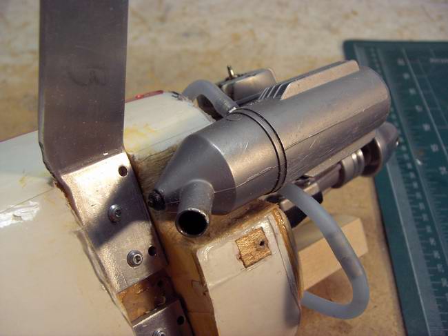

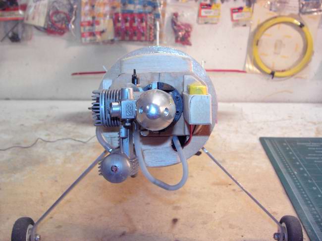

Just a word on the muffer extension though. I dislike pitts type box mufflers enormously and will not use them, overwhelmingly my choice is almost always a stock type muffler when not using a pipe with the two strokes. This often results in a difficult fit in fat fuselage airplanes with the guys always thinking of extensions and so forth. There really is a much simpler way and that is a simple muffler tunnel. Very easy to do just involving whacking out a notch in the firewall wherever needed and just shape some sixteenth inch sheet into a concave shape and glue in with some thin ca to form a rudimentary tunnel. Easy to do on most airplanes.
