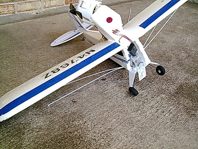

This particular trainer plane is what my girlfriend bought me about a year ago. She knew Idon't do nitro anymore and the LHS guy of course explained all the bells and whistles with the Anti-Crash Technology and free lipo blah blah blah.
Long story short my stock TX only has a range I'd say of about 150-200 ft MAX. So I have to follow the plane on land or turn it around several times. Also ACT gets confused all the time which side is up and which side is down via the 2 sensors.
Problem is with the crappy FMsystem range ACT will cut your throttle response before you are at a safe altitude! You have to remember to flip the toggle swith to turn off ACTto reactivate throttle and punch it before it stalls out and takes a nose dive.
So this happened:
Looking at the damage...I will need a new fuselage, cowel, and prop Ithink. Which will run me about $50 or so. All servos/radio system/stock brushed motor still work. Should Ijust scrap the plane and look for a better electric trainer? Or should I look into a better radio ANDrebuild the current plane?
I have a 4 channel FMHitec Laser 4 but not sure on radio range. As a beginner pilot which route would you all recommend?
So this happened:
Did you extend the transmitter antenna?
, you should have a range of 150-200ft with the antenna collapsed and about ten times more with the antenna extended.
The Hitec transmitter should be fine, just make sure that you have a proper receiver too.

Glue it back together, leave the ACT OFF! Pull the antenna out of the TX before flying, and stop trying to fly with your middle finger stuck you know where................
A Hitec Laser 4 transmitter (unless it is broken) is capable of transmitting farther than visual range on big models.

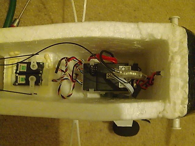

The bottom picture shows an ACT switch in the "ON" position. If you stick with the HZ radio you should keep it "OFF" at all times.
The receiver and ESC are a combined unit in the Super Cub. To switch over and use the Hitec transmitter you'll need a receiver, crystal, and ESC. You could easily spend $50 for these.

Yea a bone stock HZSC on 27 MHZ will fly under control farther than you can see. Sounds like you have faulty equipment and should check it out before your next attempt.
Rip the ACT (Always Crash Technology) out of the plane and take the TX apart and cut the wires on the switch just for good measure.
The HZSC was my first ever RC plane and I had ZERO success until I round filed the ACT. This plane will fly and land its self so I cant image why Horizon would mess around with the ACT except for higher prices.
Yes, loose the second pic its not needed.
