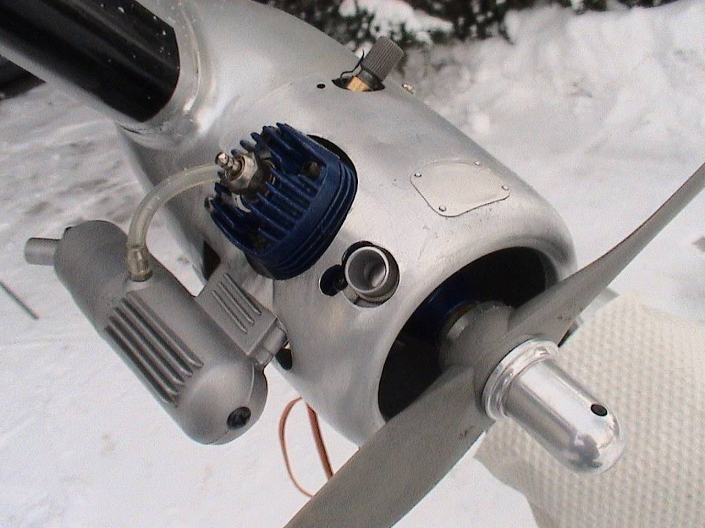

prop 7 spinner
Hi!
????Does the spinner move??
First of all! Don't use a spinner if you can!
It's much better to use a alumium spinner nut! But if it's a scale plane use a Tru Turn alumium spinner.! Plastic spinners without back plate should be avoided because they flex and could in the worst case explode!!!!!
Plastic spinners are perfectly safe. They aren't loaded with gunpowder, and they won't explode.
If you are seeing some wobble, chances are you have installed the spinner crooked. Make sure that the cutouts aren't touching the prop blades and make sure it is seated properly all the way around in the back plate. If you still can't get it straight, take it off and install it without a prop to see if it still wobbles. If so, you have a bad one and there's not much you can do about it.
Yeah the plastic spinner nonsense.... sigh...
Spinner nuts have their place, but full spinner cones are more aerodynamically efficient and scale like.
kapSidEm:
As Jester_s1 mentioned it may be a mounting issue.
Most spinners come with extra adjustment "rings" that put the back plate in place perfectly centered.
If the spinner you are using came from another plane then, it is very likely you are not using the correct ring for the prop shaft width.
The prop shaft and the spinner center should have a very snug fit, so the backplate cannot move out of center.
If that is the case, all is good.
You then have to make sure that you EVENLY tigten the spinner screws.
All too often newbies will tighten them down unevenly or WAAY too tight.
The spinner screws should force the cone onto the backplate completely with just a bit of extra strength. DO NOT grind them down tightly.
If you overtigten the screws you'll deform or crack the backplate or cone... causing the spinner tip to wobble around center.
If you've not overdone things, try loosening the screws and retighten them EVENLY. That may fix the problem.
This is what causes the "explosions" Jaka is referring to erroneously as being soley endemic to plastic.
Overtighten an aluminum or metal spinner/backplate and the same thing will happen to it! Kaboom!! at high RPM's.
But this more the fault or inexperience of the installer/pilot not the spinner materials themselves.

I see the last 2 posts...posts 3 and 4, are made by guys with about 5 years experience...apparently you guys have never actually witnessed a cheap plastic spinner "explode"? I don't mean to put you guys down, but if you've been modeling for a long time...in my case about 40 years...you'll see a LOT of things happen. (picking shards of plastic out of your buddys forehead is not a fun thing...)
All plastic spinners (the ones that are entirely made of plastic...with plastic backplates ) should be avoided...
The ones with alum. backplates are OK...
The advice about making sure the prop openings are big enough, and the cone does not contact the prop blades is very good...and make sure the backplate (prop shaft ) opening is a good snug fit on the crankshaft...no excess clearance. Use a bushing if necessary.

Not gonna argue with you Mr. Peabody...I mean after all, you know more than Clarence Lee!
(yeah, right...that's a good one...
)The only time I've seen problems with an all Alum. spinner is when a 4 stroke has backfired or kicked the prop off...and yes, that was generally caused by "user error".
FWIW I've been a flight instructor since 1975...and an Intro pilot for I don't even remember how long...own and successfully operated hundreds of model engines over those years...never "blown one up" or crashed one beyond repair. (have also rebuilt / repaired dozens of them for other modelers )
Tru Turn or Dave Brown spinners are the best choices (they have a nice / thick backplate ) or the Aluminum backplate spinners with the groove all the way around the backplate for the nylon cone to seat into. It is a good idea to get into the habit of using high quality equipment. (Some of those cheap ARF aluminum spinners can be almost as bad as plastic...too thin and flimsy )
Spinners with plastic backplates will most likely distort, especially after the prop nut has to be re-tightened after a while. Just having the prop nut "tight enough" can cause a plastic backplate to distort...it doesn't even have to be "over torqued" to cause problems.
This whole hobby is about doing things the right (correct ) way, isn't it!? IMO using a cheap spinner with a plastic backplate is asking for problems. They usually wobble which puts more stress on the bearings, and can cause fuel foaming, and puts more vibration through the radio system, airframe, etc. etc.
But to at least try to answer the O.P. question...sometimes just repositioning the spinner assembly can change thinge enough so that it doesn't wobble...or wobbles less.
Also, you can get yourself a Top Flite or DuBro balancer and check the instructions...and try a search on spinner balancing...there have been discussions about this in the Glow Engines forum.
http://www3.towerhobbies.com/cgi-bin...&I=LXD712&P=ML
http://www3.towerhobbies.com/cgi-bin...&I=LXHY61&P=ML
