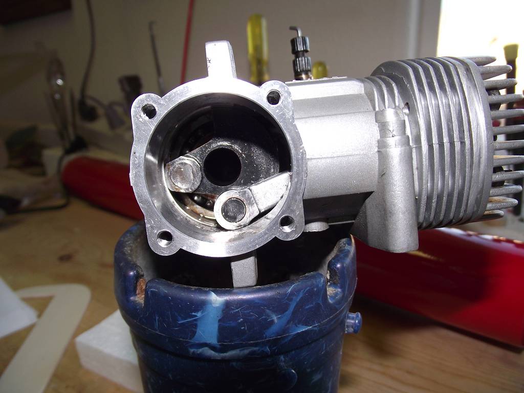

I just had my first broken engine today. Just flying along and my new SK .91 broke a rod, maybe a crank? I haven't opened it up to look yet.

GB one of our locals tried a new SK 1.08 about two years ago During the first runs the connecting rod and or the rod journal broke. The airplane never got to fly and the gentleman doing the brake in was no beginer and a well versed engine man.
I cannot give you the exact specs but the engine was immediately returned and it was replaced without question. The problem was the replacement engine did the exact same thing. It was a complete writeoff and he just threw it away.

Day one of phoning Kangke/Superkraft was a waste. I had problems getting in touch with them when I ordered the SK engine. I question if Kangke is still a full time operation shop these days. I start calling at 9:00 and phone every hour.

I was able to get hold of someone at Kangke. They gave me the number of the service center. Seems there is no one home there either!! I did pull the back plate off the SK and took a look. The big end pin on the crank had broken off, looks like it was sheared pretty clean and flush with the crank.
This is identical damage to what happened to the local I spoke of in post #2 both the first new 1.08 and the replacement 1.08 that was sent.

John, I went into the glow engine forum and noticed this has been happening. My other SKs were fine. Two days of phoning and no one to answer a phone?? I got hold of one fellow at one of there outlets and he refered me to there service department. Been calling all day without any luck. I will take the replacement but Kangke is another place I will no longer order from or refer to. If they can't staff an office or pick up the phone then I can't be bothered with them either. My wasted time is worth as much as there time is.
No expert here but a finely sheared crank journal seems indicative of a metalurgical design problem.

That's definitely a manufacturing fault. I'd been wondering if they used a press in crankpin but that one seems to be machined as part of the crankshaft. The usual cause for a break like that is too small a radius where the crankpin blends in with the crankshaft giving a stress riser or overhardening making the pin brittle. Or a combination of the two
