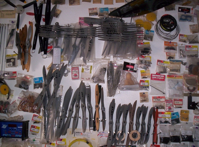

I too have accumulated a lot of props over the years. Actual flight testing is the best way to find out for yourself which ones you like best.
Most of the guys I know who have been at this for a while have a fairly large "collection" of props.
