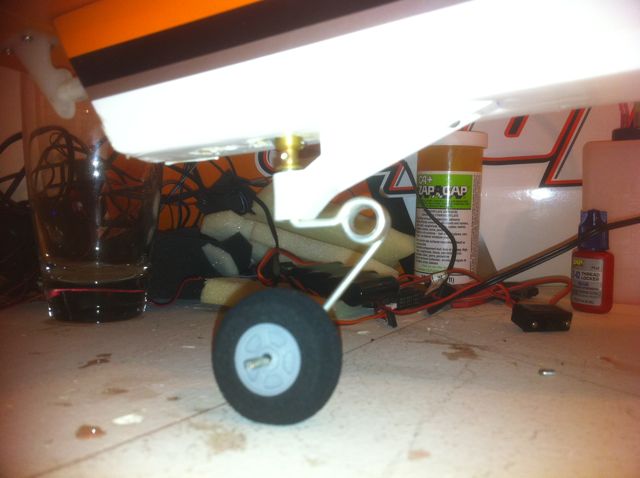

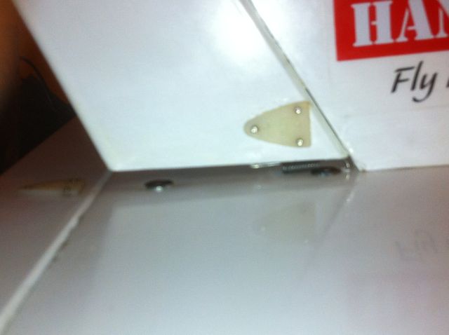

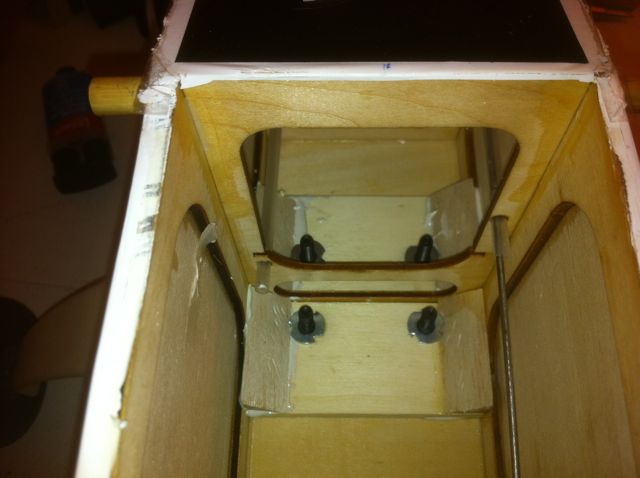

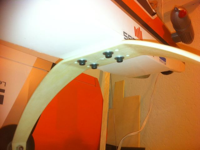

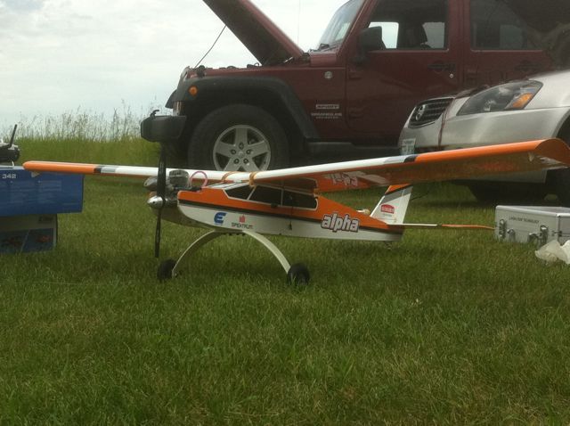

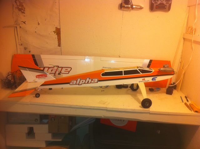

New to this site and to RC flying. I'm addicted already! Bought a Hangar 9 Alpha .40 RTF trainer and learned how to fly on that. Second plane is coming soon. Ive already started to mod my Alpha. Converted to a tail dragger with lots of info from RCU. Im currently working on taking the dihedral out of the wing and made new ailerons for it. (1 3/4" vs 1 1/4") More pics when that is complete.

Welcome and a very nice, clean looking mod to a TD.

Nice looking mods to clean up the Alpha.
Your langing gear sure are bolted on secure... One thing I have done, and han help new pilots with keeping some hard landing damage to a minimum is use nylon bolts on the landing gear.
With 4 bolts, you will have plenting of holding power, but they can still shear off in a really rough landing. What you have will keep the gear on, but take the mounting plate and some of the airplane sides off in case of an incident. Just an option. Use the same size nylon bolts/screws to fit the holes and blind nuts you just installed.
It has worked for me more than once before

Nice job on your trainer mods. I am curious though it appears that you extended a rod from the rudder axis down through to the tailwheel axis, I must be missing something how can that work through the 25 degrees or so between the two axis.
Just a though if you really want to make it a great flyer don,t just flatten the wing as you said you intended but go all the way to the neutral roll axis and droop the wing about the three inchs at the tips or roughly the same droop as it formerly had in dihedral.
Just flattening the wing only gets you half way there.

The tail wheel rod is bent at 90 degrees and up through the fuselage into the rudder. Looks decieving on the pictures. Works pretty good for the tail wheel being rudder controlled only. I think i am going to have to replace those metal bolts for the mains with nylons. I didn't think of that. Thanks for the tip.
