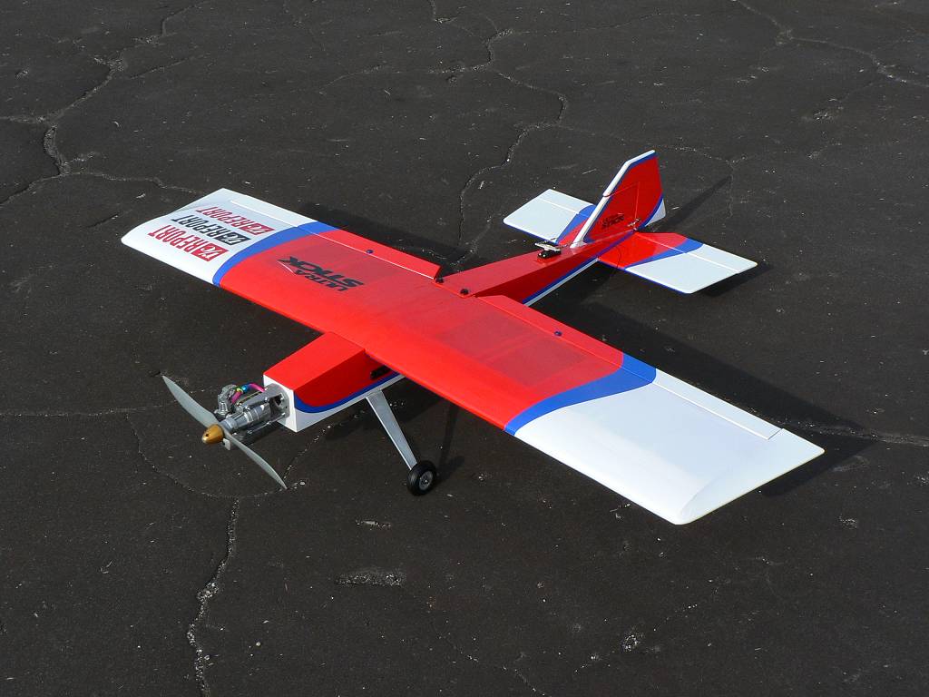

Old 07-22-2011 | 08:15 PM
JohnBuckner's Avatar
Posts: 10,441
Received 11 Likes on 11 Posts
From: Kingman, AZ
Default RE: avistar mods
ORIGINAL: skysail
Hey everybody,
I built an avistar this summer with an OS 46. I learned how to fly it pretty well and started to do aerobatics with it. Can anyone recommend any ideas or modifications to help my plane fly better for 3d before I invest in another plane. Im also wondering what the best size prop would be for this engine.
thanks
ID:	1638756   Click image for larger version
ID:	1638757   Click image for larger version

I currently have my Avistar uncovered for bigger ailerons with dual servos and am going to set up the center wing servo for flaps using the stock aileron linkages.
Also am going to flatten the wing and clip the tips square. Considering 1-2 degrees Anhedral also.
I really like the 12x4 APC my .46FX and a taildragger conversion makes it a little sportier too.

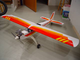

I like where 1320's going with the Avistar. The wing rib semi-symertrical rib profile provides for decent aerobatic patterns. Reduce or eliminate the dihedral. Tail dragger? Only if you like a tail dragger (I do). Think about eliminating the rubber band approach or make sure that you have plenty in use to eliminate any possibility of the wing separating from or slapping the fuse. Cut the wing cheeks off so that you have better access to the engine &amp; mount. With a bigger engine - reinforce or double the firewall. An Evolution 52 or OS 55 AX will give it plenty of scoot. Or a Saito 82 if you like 4-strokes (have one on my Hanger 9 ShowTime 50 which is a 3D-capable plane).
The pics show a bulky (guessing it was builder's 1st time) tail wheel, a 2nd rudder servo control rod for the tail wheel, the main landing gear support. It has an Evo 52 NXmounted. Icloned the approach shown in the pics for mine with the addition of 1/4-20 nylon wing bolts.
It kept new trainees happy doing "aero"maneuvers more easily than the tradition flat-bottom rib profile of most high wing trainers.

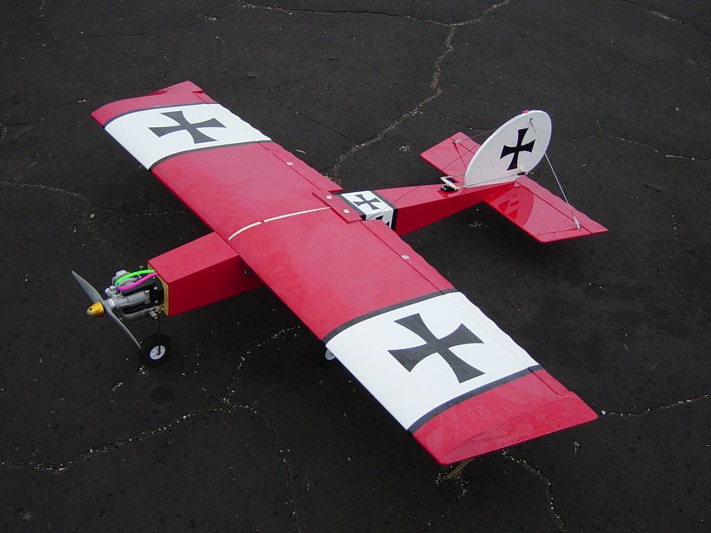

Finally finished my mods. After dragging A__ on this project I blew it out last week before going back to work this week.
I did end up uncovering the wing completely and separated the halves with a hack saw blade.
The metal brace was bent in the center to negate the dihedral built into the wing tube.
New joiner made out of 1/4" 5-ply.
The flaps work perfect and I simply bent one of the stock linkages 90 degrees to touch the other one and soldered them together.
Robart hinge points were used for all hinges.
Aileron and flaps both had the hinge gaps sealed with covering.
The plane flys beautifully! It is very precise in its movements and holds lines without wondering off.
Reminds me of my pattern ship.

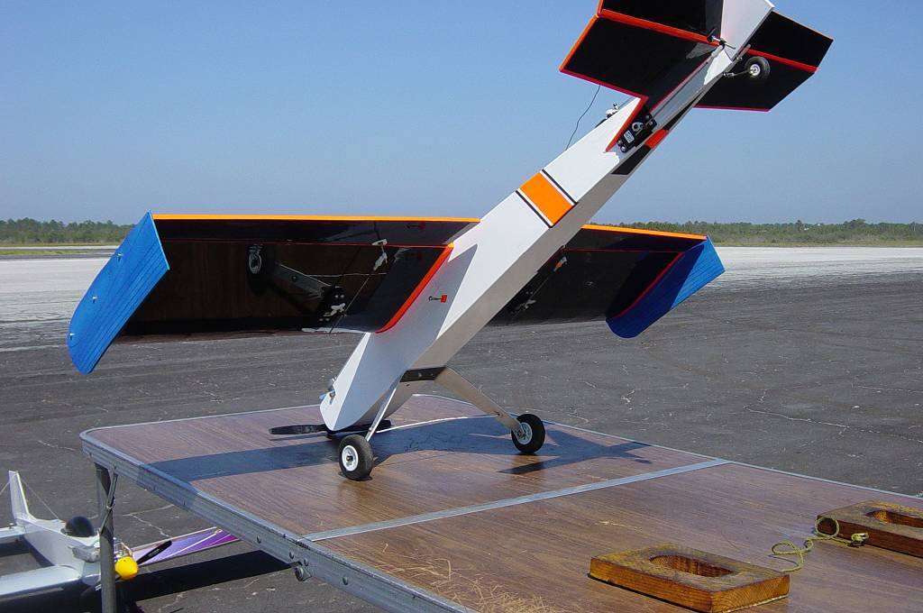

Nice looking mod to your Avistar.
Take your plane up, fly straight & level and slowly add in some rudder. The plane will roll in the direction of the rudder. This is due to the high wing location on the fuselage.
What you need is 3 degrees of anhedral on both sides to compensate from the wing location. I've done several planes this way and it'll let you fly knife edge and point rolls without aileron correction. Works great on Sticks.
A trick to cure the roll without cutting the wing apart is to add downward only end plates. You can make the plate from lite ply. Cut it even with the top of the airfoil, but extend 3/4"-1" below the airfoil. Hold it to the tip with a couple of servo screws.
ID:	1730466   Click image for larger version
ID:	1730467   Click image for larger version
ID:	1730468   Click image for larger version
