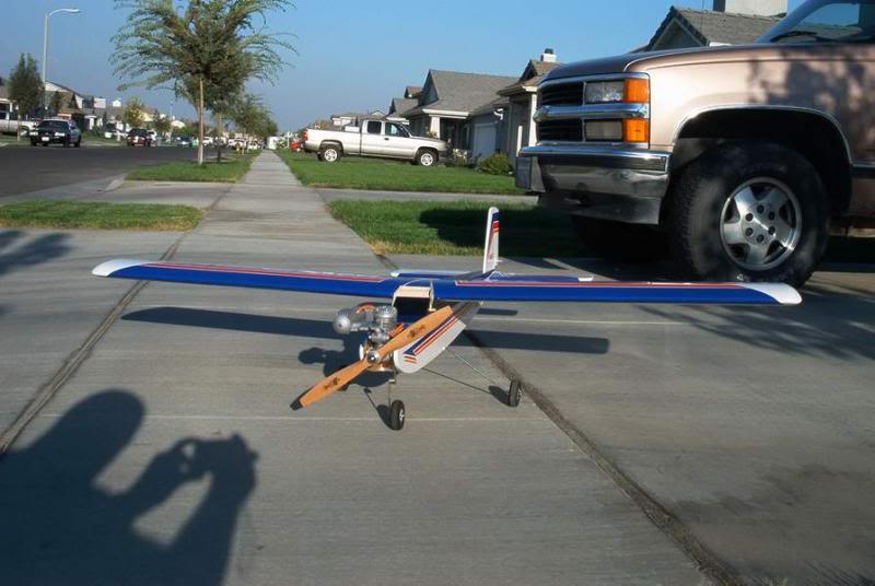

Sorry I am at work so not pictures. I am not going to worry about it I just ordered another landing gear.
but here is a picture of the way mine looks, not a close up but this should do.

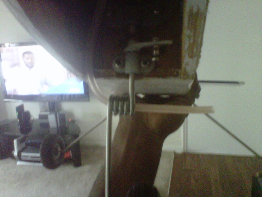

Here are my pictures. The wire is not bending, it seems as though the spring is making it flex. I have already ordered the nose gear that mudboger07 suggested. I says up to 15 lbs so it will be great(overkill)
I am still curious though...so suggestion will be taken!

There is nothing in your photos to indicate a mechanical problem but there is a clue as to what is really going on.
Your rudder pushrod is far to close in on the steering arm (about half way) This will in every case cause excessive nosewheel travel and the steering will be far to sensitive when on the ground.
You said this is your first tricycle geared airplane and you only do taildraggers, well all the different forms of landing gear geometrys require different piloting techniques as well as set ups and excessive wheel travel is definately a common mistake with trigeared airplanes.
Here is what happens with this excessive travel. Folks will suffer steering excursions in both directions and both during takeoff or just after touchdown. This will result in many tip ups and flop overs with the resultant prop strike.
The worst case senario after landing is after you past yourself into the wind and attempting to turn back down wind with still to much speed the excessive throw will result in a flop over.
I beleve there is nothing wrong with your landing gear other that the steering throw.
John

Thats because the hole in the firewall is in the wrong place. Yes I am aware that it may be where the factory placed it but regardless its in the wrong place. It needs to be directly lined up with the end of the arm and that is usually clear over to the side or close to it. The pushrod needs to all the way in the last hole out at the steering arm and at the servo always start with the pushrod at the closest hole in.
If your firewall outlet is aligned with the end of the steering arm and hole is drilled oversized with any rod housing if used floating free you will be rewarded with an almost friction free steering and that will make a big differance.
If a housing is used it can be glued at the the first cabin bulkhead to prevent it from sliding fore and aft, this when the housing floats free in the firewall.
The reason for this is the fire wall is always to close to the steering arm and as the pushrod moves it swings sideways and jams aginst the bulkhead actually trying to bend the pushrod.
The Fults is a wonderful gear for a heavy airplane but very much overkill here but worse it will not cure your problems which apparently are the flopovers and propstrikes. Fixing you linkage will cure the problem however.
Excessive nosewheel throws and or binding pushrods are a recipe for poor ground handing i.e. flopovers.

I agree with RCKen and JohnBuckner. The nose gear should only turn about 10 or 15 degrees at full throw. Any more than that and you are going to trip up your trike.
And also, moving the pushrod out to the end of the tiller will increase the mechanical advantage the servo has over the nose wheel.
