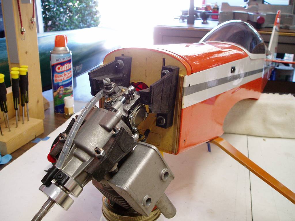

I have a DLE-20 in my Pulse 125 and can report it flys nicely with it but I found the install inconvenient due to space limitations. The stock gear sweeps too far back for grass but is reported to work fine on pavement. I've never flown off pavement and cannot say myself. But I think the DLE-20 is overkill on this plane and would imagine a nice 120 four-stroke would have been better.
If you fly it constantly you will enjoy the fuel savings. Consider dual elevator rods as well.
Good luck with your Pulse,
Clay
The included nylon engine mounts broke on a hard landing and I've gone back with a cast aluminum mount.

Hmm... yours is the first opinion I've seen that the DLE 20 and the Pulse 125 are not well matched.

Make no mistake; I love mine and its a great combo. Just way more power than it needs. BTW, the plastic mounts that came with the plane snapped clean off on a hard landing and I've gone back with H9 aluminum mounts.

The DLE 20 manual recommends a Du-Bro mount - DUBG1307. I've had no luck finding it, but it appears to be the same as DUB688. Did you consider that one?
