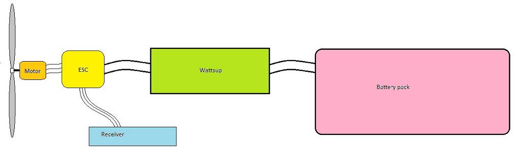

CGRetired is most likely to be correct in his assessment that the battery does not have enough capacity to sustain the load imposed upon it.
Melnick123, don't assume that "sputtering" has anything to do with it.
What you believe is "sputtering" indicates that the ESC's timing MAY be off a bit and may need reprogramming... however that is unlikely.
The ESC may be perfectly fine for your motor as is, you are just not used to the idiosyncracies of motors.
You should borrow a WATT meter from a fellow electric flyer and put it between your battery and ESC.
Then run the plane up to full throttle and observe the maximum amount of WATTS/AMPS the motor draws and the voltage.
If you are running a 3S pack, and the voltage drops to say 10.4v then the battery simply doesn't have enough power to supply the required energy to the motor.
If on the other hand your motor is rated at 200 watts and the highest draw you see on the watt meter is say 120 watts, then your prop is too small, so you are not getting enough power out of the plane.
If the motor is rated at 200 watts and the highest draw you see is over 200 watts, then your prop is too large and it may ruin the ESC, motor and battery..
All of that said, some ESC's "learn" the throttle range of the TX, and sometimes when you start changing things, the ESC may not remember the full range of the TX... in a situation such as this you must do the proceedure documented in the ESC's manual on how to retrain it for the throttle range...
I'll put my money on the battery pack issue though.

I also had problems with not being able to get full power. Take the prop off and see if you get full power. If you do then you mayhave a wire connection problem and should resolder.
You don't understand the physics here. The power drawn by the system... system is the battery, ESC, Motor, and the prop, is as a unit, meaning everythiing contributes to the power consumed. This is how you measure the current draw, as a unit, using something like a "Wattsup" watt meter.
http://www3.towerhobbies.com/cgi-bin...&I=LXLMV0&P=ML
Remove the prop and you have no load and the motor will turn at it's KV rating. The current draw will be minimum. Solder joints do not make one bit of difference. The chances of a cold solder joint on an ESC from the factory are so slight that it's just not worthy of consideration.
In other words, put the soldering iron away and look elsewhere.
Look at the sketch I've attached here. This will give you the best indication of what may be going on here. And, I can almost 100% gurantee that it has nothing to do with solder joints, unless you have already messed with them. If you have, well, all bets are off.
CGr.
