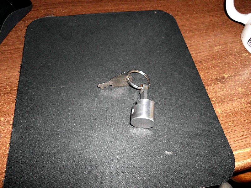

I've had no luck with glow Evolution 2 stroke engines. They either leaked from gaskets, over heated, lost compression or bearings wore out quickly, or the rings went bad. I had 3 of them- 46NT, 46NX and the 61NX and the eventually they wound up in the trash. But I did find that the pistons do make excellent key chains!
So far, the only engines I like the most are Saito and O.S. and to me they are worth the extra cost.
