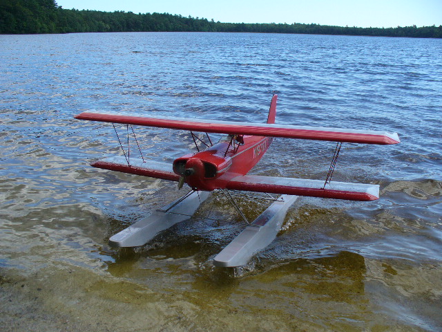

I have just built a Sig Astrohog and I covered it with Solatex (iron on cloth). It is brilliant stuff. It is very easy to iron on, far easier than Monocote as it will stretch around compound curves quite well.
I am also in the process (a very long and slow one) of building a Sig quarter scale Clipped Wing Cub. I have covered it with Sig Coverall. It too is a cloth but it needs to be held on with dope or you can use a heat sensitive glue like Sig Stixit (which I have not used) or Solafilm's Balsaloc (which I often use). Balsaloc is water based but I think Stixit is solvent based. You then tighten it with your heat iron (easy) then dope it with thinned dope to seal it then a few coats of dope followed by primer and paint. It is easy to get carried away with the paint finish and end up with a very heavy plane.
Back to Solatex. It is my favourite covering. It comes pre-painted with an epoxy paint and is very fuel proof for the glow fuels that I have thrown at it. It can be painted also as well but you do not need to paint it. I use small tins of enamel paint to paint stripes etc on top of it.
Solatex comes in two types - standard solid colour and a translucent which is called "classic". The solid colour is mostly solid but you can see really dark marks through it and good preparation is necessary for a good result. A coat of clear over the solid does help to deepen the colour. The standard paint finish is flat.
Most of my larger planes are Solatex covered. I have only completed one plane which was Coverall covered but I have seen plenty where I used to fly. Sadly, many were very pretty but also very heavy with the expected results.

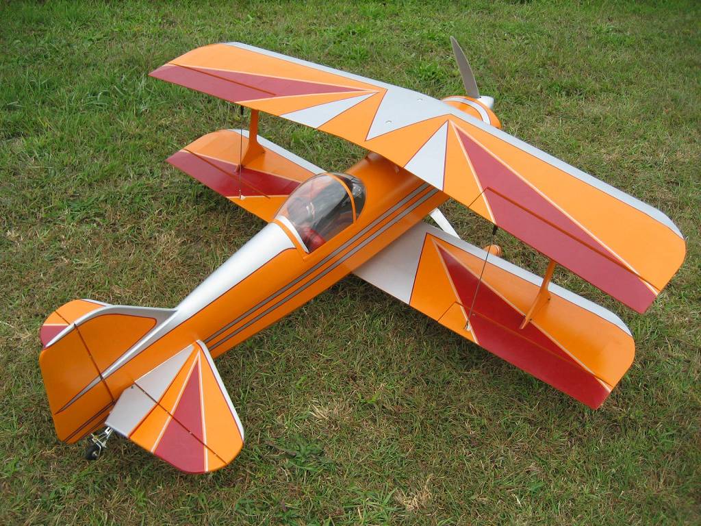

I've read a few comments saying your first paint job won't look as good as monokote. That might be true, it also might not, depends on the persons abilities, and if they've done a little research and prep work and how complicated they get on the color scheme. Also depends on what you think looks good, I can't stand most arfs with all the multiple swishes and swoops and 8 different colors.
The first kit you build might not look as good as an ARF, and you won't do as good a job covering it as someone in china would, but it you let that stop you, you'll never build a kit to begin with. So yeah, don't expect your first paint job to be perfect, use it as a learning experience. The one thing to keep in mind on your fist paint job is if you have to decide between light weight and good looks, go with light weight. Keep the color scheme simple so you don't have multiple coats on top of each other.
A color scheme doesn't need to be complicated to look good. Here's a Phaeton 90. The whole fuse is red except the stab and stripe, the wings are silver with a read leading edge. Simple.
