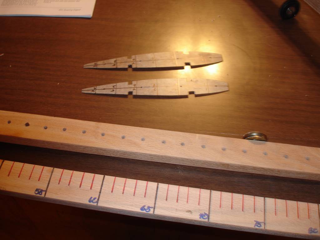

I have watched several videos of cutting foam, both manually and semi-automatic. Most of the cutting that was done was with a smooth wing, no slots for spars. I built a automatic foam cutter via plans from tailwindgliders.com. By a gentleman named Curtis. I don't understand how to do the wing with the spar cutouts in it. Looks like the hot wire will not drop down into the slots. Do you cut the slots last after the profile has been cut? I will include a picture of the wing rib profile so you will be able to see what I am talking about. Thanks`

The foam core is cut to the planform then the airfoil shape. Make sure you cut the bottom of the airfoil first then the top or your airfoil will be thinner. Then you prep the core with spars slot, holes for servo wires, etc.... Then you apply the skin of your choice; ie. composite material, balsa using epoxy, gorilla glue etc...

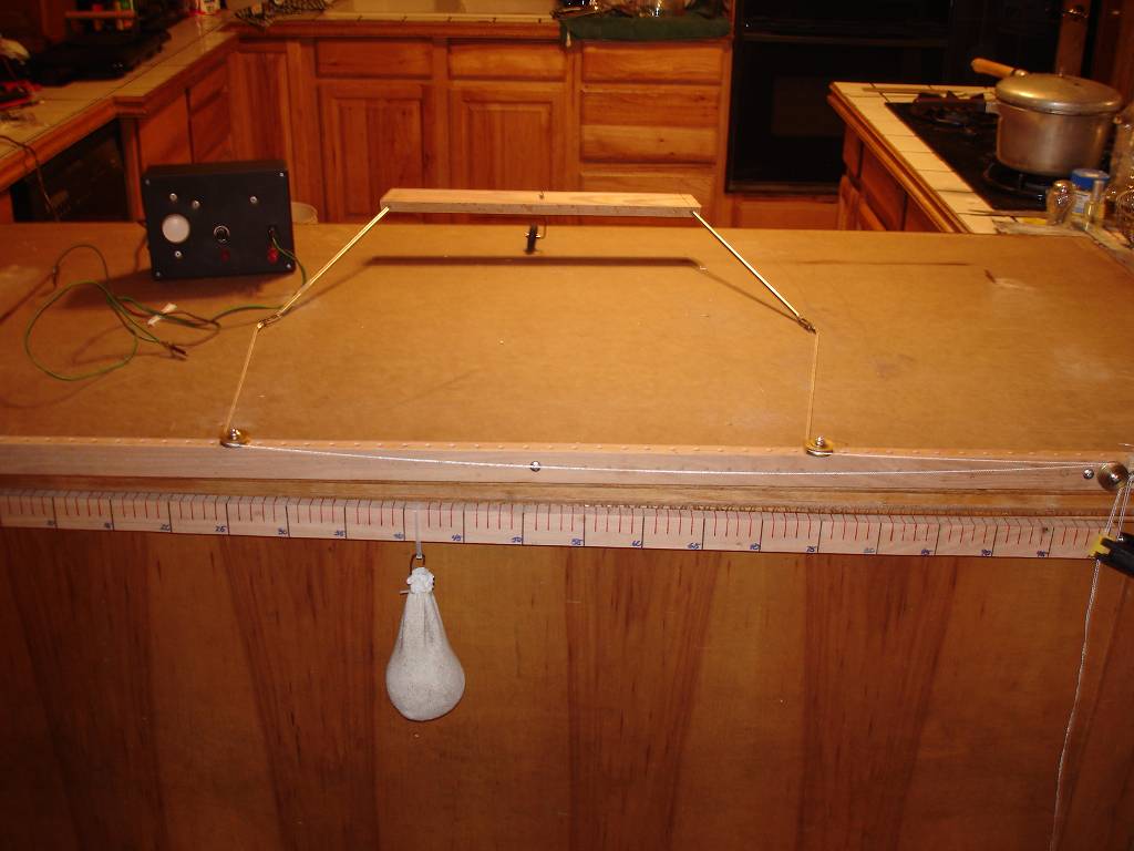

Here is a picture of my foam cutter. Now I just have to figure out how to work it.

I just want to pass along my thanks to cloudyIFR (Curtis) for all the help he has given me building my automatic foam cutter. I have ask many, many questions and he has responded quickly and friendly. If ever you think of building one of these cutters I'm sure Curtis would appreciate letting him know how it is working. Thanks again CloudyIFR.

CloudyIFR, Have had a chance to practice with the automatic foam cutter and to say the least this is the cat's meow. All I can say is that this works GREAT!!!! Thanks Curtis.

Wish I knew how to do the videos. This thing is so slick. Using the pink foam I don't even think any sanding needs to be done before putting the skin on. Maybe someone will chime in and tell me how to post a video.
