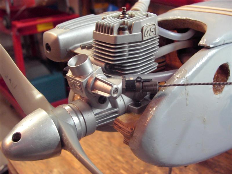

Another possibility you should confirm is that the Low Range needle (LS) that you set at 1.5 turns out actually is the Low Range needle(LS).
All the AX's except the .46AX use a new series carburator that utilises a different principle for the LS metering. It is on the opposite side of the throttle arm and on the tip of that cone near the fuel inlet nipple
This is a considerably different set up than the common setup with a typical double needle midrange and lots of folks get hung up on this point.
John

John: Do you, per chance, have a picture of that?
CGr.

Hi CG, Just got back from the field this morning flying my little nostalgia airplane, with a .35AX on it and I will make some photos in a little while.
John

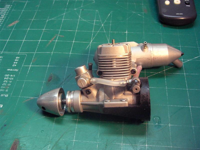

Hey CG here are examples of a .35 and a .55AX's showing the left side of the engines (facing forward) and the midrange screwdriver slotted needle is clearly visible in the end of the cone that the both the fuel inlet nipple and the main needle are also located. I am pretty sure this is the case with all the AX's except the .46. I only have one .55, three .25 and three .35AX's.
The last two photos (correction the second and forth) are both sides of a .25FX which uses the older carb and is the a setup widely used by many manufacturers. The slotted mid range needle is clearly seen inside of the throttle arm barrel, right side and I course I am sure most folks are familiar with this setup
John[8D]

Ah, THAT screw adjustment! Got it. For some reason, I was thinking it was on the other side.
I think I need a little adjustment on one of my engines and was wondering what one was the LS needle. Now I know.
Thanks, John.
CGr.
