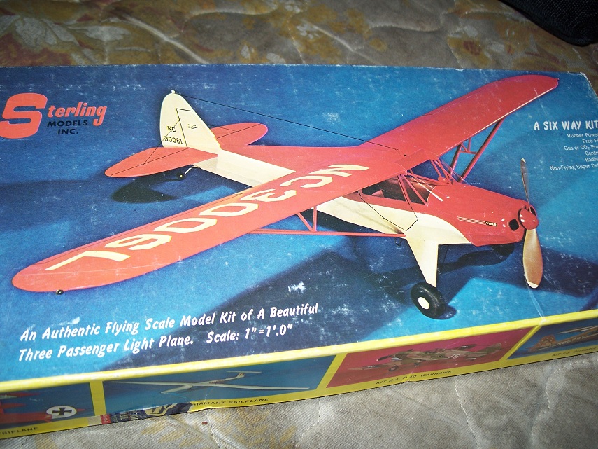

Sterling Piper Cub Super Cruiser PA-12 35 1/2" wingspan.

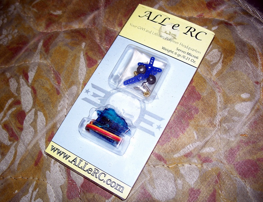

plan on using the other components pictured too: Micro6 servos from All e RC (weight 6gr/.21 oz),
7.2v/270mAh NI-CD battery pack, Hitec feather single conversion ultra light receiver
I have a E-Flite Park 450 Brushless Outrunner Motor, 890Kv
E-Flite Park 400 Brushless Outrunner Electric Motor 920Kv
or a Nano Brushless Outrunner RC Motor 2024 KV1400
I would like to use one of the three I already have.
