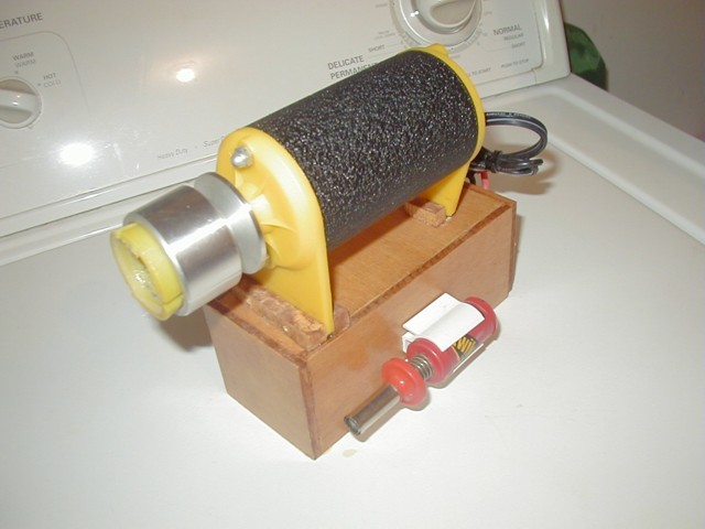

Old 09-18-2003 | 08:21 PM
My Feedback: (17)
Posts: 2,106
From: San Antonio, TX
Default RE: Cordless Starters
Here's mine. What can I say, I like working with wood.
Old 09-18-2003 | 08:27 PM
My Feedback: (17)
Posts: 2,106
something's wrong, having trouble downloading the pic?? Here it is.
