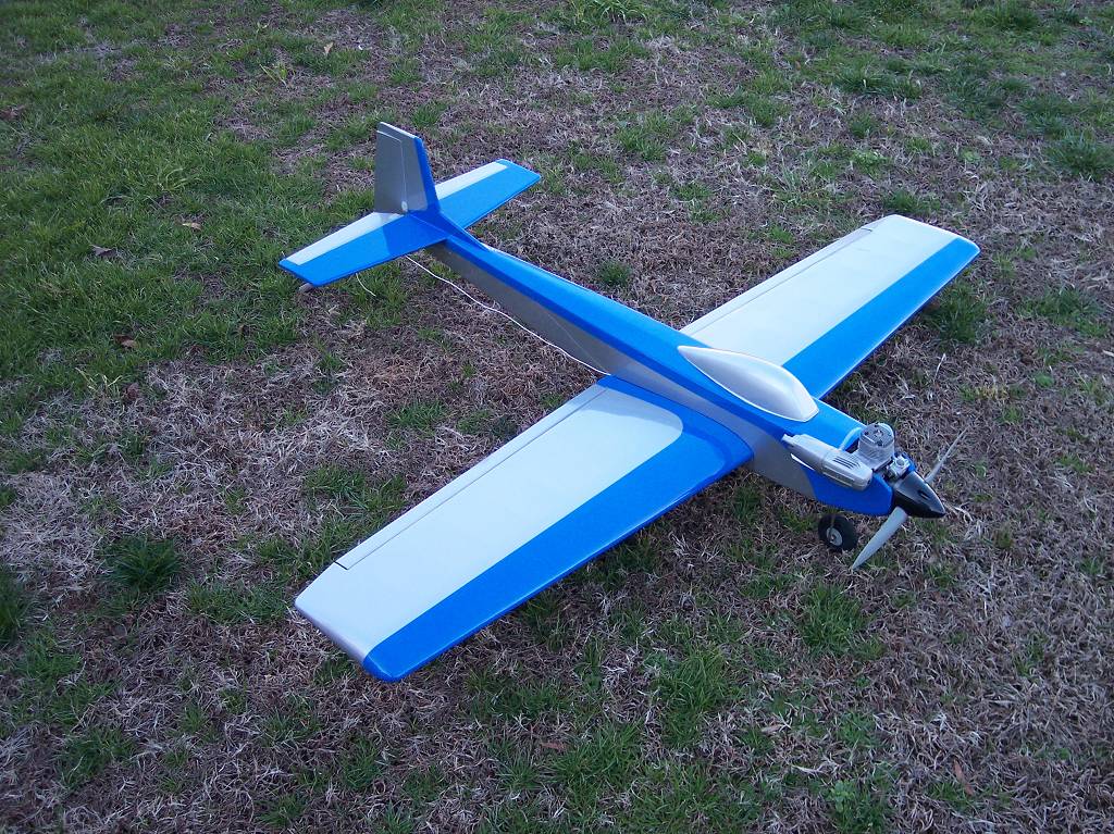

Old 11-20-2011 | 01:54 PM
gene6029's Avatar
Joined: Sep 2007
Posts: 1,219
Received 20 Likes on 9 Posts
From: wilson, NC
Default RE: What is a good engine for a Tower Kaos?
I currently have an OS 55AX with APC 11-7 on my Tower Kaos & its ballistic on 30% heli fuel!....Gene
