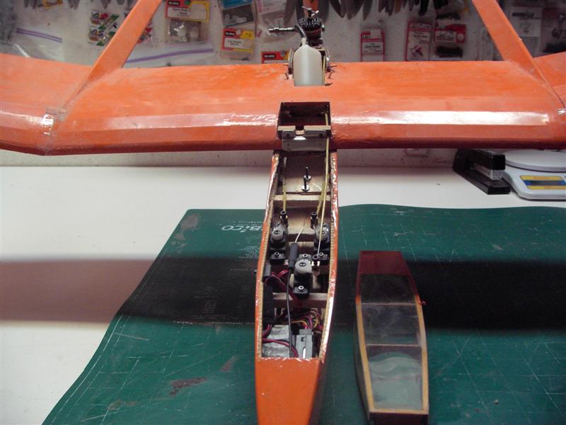

Here is another of my much more compact airplanes: a home brew I call the Orange Thing. with a 1.5cc diesel and you can see the botta about half way between the engine and the big lead box up front in this pusher.

The picture of the BODA surrounded with servos in your "Orange Thing" answers many guestions. Thank You. I knew about the velcro. Do you think the velcro cuts down vibration ? I'm still concerned about putting a loop in the leadwire to the boda!!

You know I am sure velcro does reduce vibration, I don,t see how it could not but anyway using the hooks and loops has become a standard for me and I certainly don,t feel I am any worse off. I actually got into using it before 2.4 in my pylon days and I could not see any higher damage rate than with the foam. Actually what I have noticed is that the 2.4 rx's seem to be far more durable in crashs than the 72 units, go figure.
As for the range in the power down mode, don,t know I don,t bother rolling more than about fifty paces.
I have many airplanes with the antenna leader wire running with a 180 'U' turn but no full loops and I am totally comfortable with that. Have not found an airplane yet that I cannot stuff a 6 or 7 channel 2.4 in, in fact I got an awful lot of the sevens but only seven of the six channels.
I also am working on my next Ukie and it will have the Hitec six's on board for throttle and stooge release. This instead of my old over the wire electronic system. Guess I won,t have to do range checks on those since the airplane can never be more than sixty feet away
Are all three of your Optic Six's the same model or is the 2.4 the low voltage six cell instead of the eight cell version? I know that for me to buddy box my two Auroras with the Optic Six that the Optic must be the six cell low voltage version.
John
John

All my Optic 6's have eight cell 2000ma. eneloop batteries, with removable modules. I plan on replacing the two with 72 modules with 2.4 once I trust and understand the 2.4's.
Thank you again. You are a credit to modeling,and R.C.U..
Matt
Matt
The way you have things routed in the orange thing makes me feel a lot better about how to run things. I was concerned about running between two servos and there metal control rods.
I got a chance to range check the Hitec optima 7 and eclipse 7 setup tonight . I could only get 35 feet away before I lost signal. The instructions say I should be able to get 100 feet away in power down mode.
Can any one see any thing I may be doing wrong in my set up?
