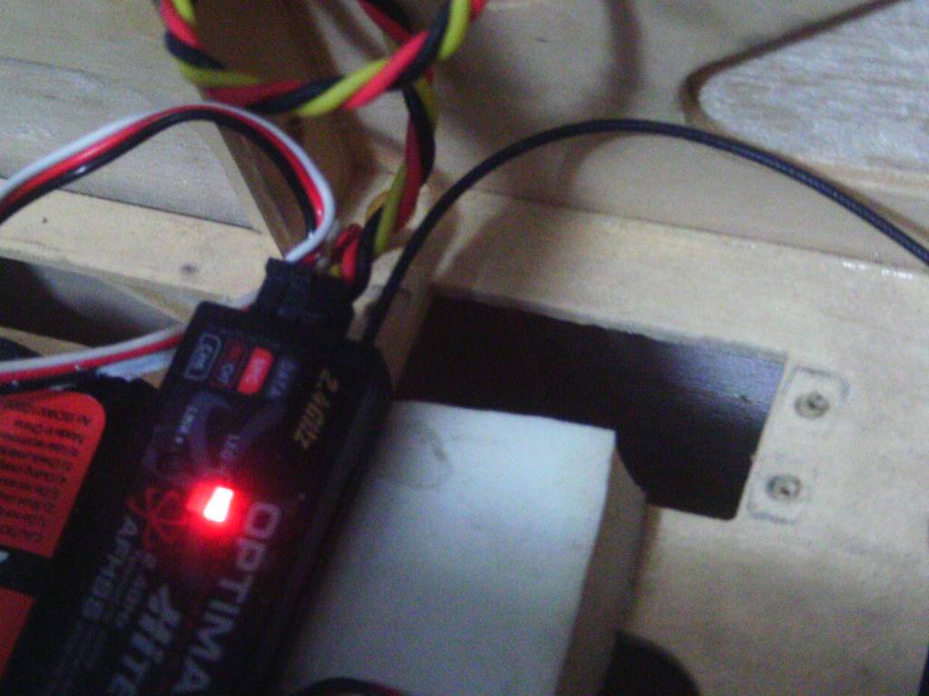

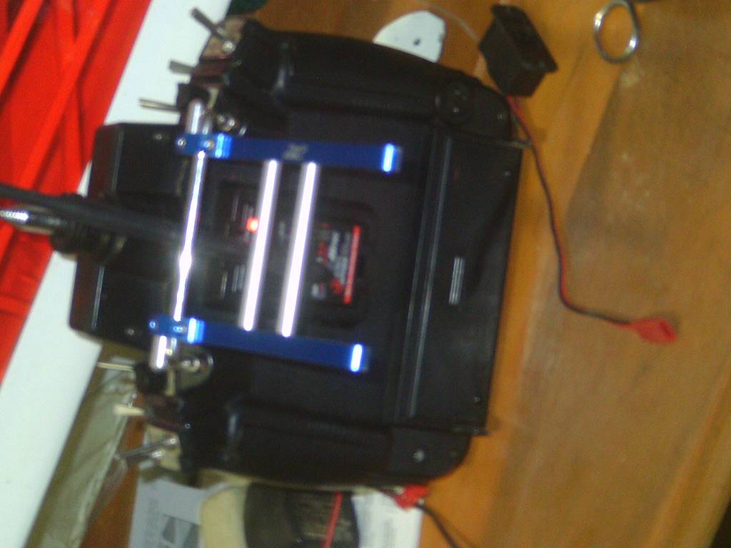

I got a chance to range check the Hitec optima 7 and eclipse 7 setup tonight . I could only get 35 feet away before I lost signal. The instructions say I should be able to get 100 feet away in power down mode.
Can any one see any thing I may be doing wrong in my set up?

I suspect it may have something to do with the antenna close to and running the same direction as your rudder cables.

If your Optima 7 Receiver is updated to at least ver 2.02(0) and your module is updated to at least ver 2.01(0) then perhaps its time to send the three components in to be checked out. This includes the Eclipse, the module and the rx.

It is strongly suggest by Hitec that all Optima Receivers, 2.4 Spectra Module and if you are using the Aurora it also should be updated.
I am only an individual but will not attempt to fly any of mine that have not been updated period. Now I have seven six channel receivers that are not current and I currently am getting them all ready to return for updating. I have many others but all those are seven's and up and update them as it comes time to fly them a few at a time with my HPP-22.
I recently got in six more Receivers and its interesting that there is a sticker on the box's that indicates these newest are the latest update and gives the actual update code so you can fly with confidence without updating.
I consider having the ability to update ourselves a real and viable asset to using this 2.4 technology and definately do not consider this a problem its a hugh asset. I know Futaba has updating ablity also for certain of their setups also.
There is a high population of Hitec systems at our field and in some cases the HPP-22's have been shared but at thirty bucks or so I definately want my own and am confident in continued support in update by Hitec.
Bottom line for me is I not only will not fly any of my own systems that have not been updated but also will not fly any of my students stuff either teaching or just testing that is not updated, period.
Sorry I know you did not want to hear that but it is my opinion.
John

My next step is moving the antenna to a vertical location and removing TX stand.

You want the antenna to be horizontal just keep it away from anything metal

I got the HPP-22 and updated the TX Module tonight. I am also going to pull the stand off tonight. Hopefully I can get the RX updated in the next day or two And do another range check

This is where I am at.
Updated the receiver and the module.
Removed transmitter stand.
routed antenna out the top away from every thing.
Results :
Range increased from 35 feet to 65 fee in the power down mode still 35 feet short.
Suggestions ?
