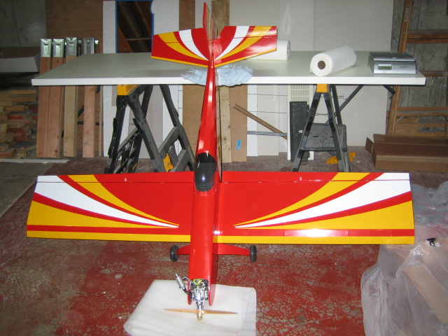

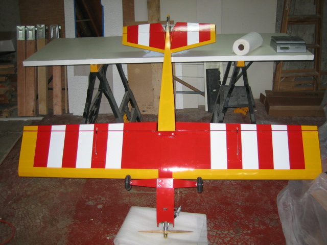

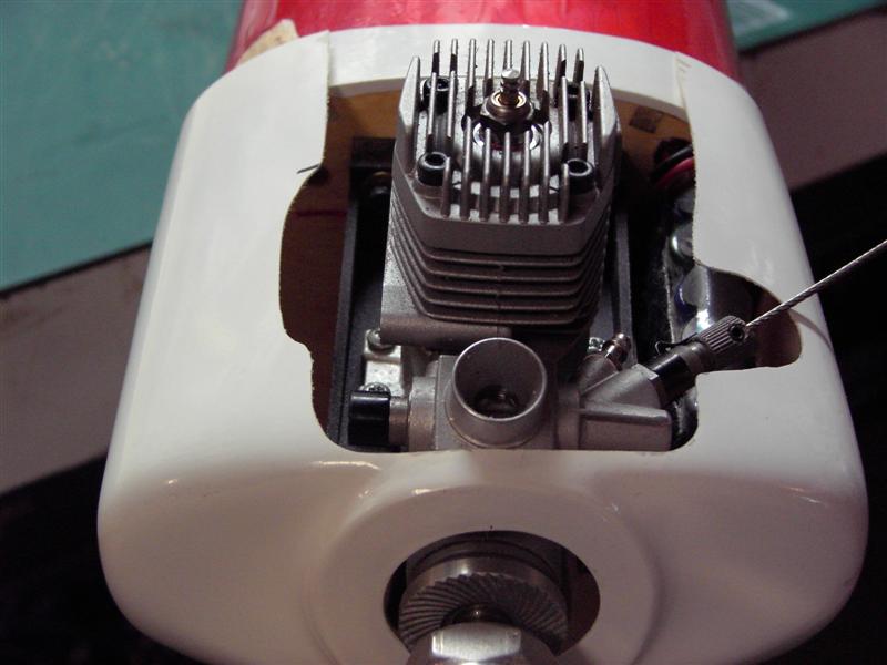

Default RE: Reducing weight 4*60 tail
Yes I have done so on many airplanes but mostly old timer types. As the others seem to have hinted at, its often for very little gain especially on that type airplane.
If you are doing this to help with a CG problem (CG to far aft) Then here is a very effective method that simply moves the battery forward along side or under the engine and invloves no adding of lead.
John

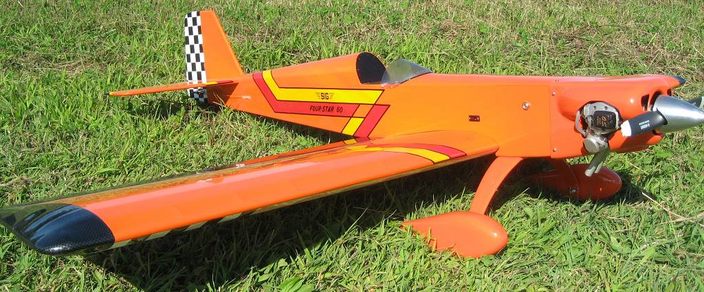

Do you mean elevators and rudder? Maybe you are talking about the ARF? I built a kit and the horizontal and vertical stab are built up. I tapered all of my control surfaces from front to back down to about 1/16". That got rid of some weight and made them look much less clunky. I used an OS fs-91, cut off the cheeks and used a fiberglass cowl on mine, it was a bit nose heavy until I moved the battery back into the fuse behind the wing.

Thanks for the responses. Based on the calculation, I don't think that it would be worth it although, previously I added triangle stock on top and bottom of joints to horizontal stabilizer to strengthen and no doubt that is part of the reason my tail is so heavy. Also, upon my first rebuild of this plane, I used too much 2 part epoxy and added too much weight. I am starting a build of a 4*120 and will not make the same mistakes. I will cut off the cheeks and use cowl and build mostly with CA and in general be more careful about adding unnecessary weight. The orange plane is beautiful and I would be happy to make my 4*120 like that one. Thqnks, I will leave the 4*60 stabilizers alone.  Wayne

Smithcreek - who's the cowl supplier?

Old 12-31-2011 | 11:54 AM
Joined: Feb 2006
Posts: 4,465
From: Arroyo Grande, CA
Looks like a Fiberglass Specialities one. They have them and wheel pants. For the wheel pants, I used the ones from the 60 size U Can Do, along with the Dubro heavy duty composit landing gear.

Old 12-31-2011 | 02:32 PM
Joined: Sep 2010
Posts: 39
From: s.daytona, FL
The cowl shall be Fiberglass Specialties. I bought the plane used but I believe that it was a kit. I suspect you are right about the build-up as I just supposed that it was solid which If sheeted I may have gotten fooled. Anyway, I have given up on the idea based on the responses.  i like the idea of putting the battery under the engine. I probably won't be able to do that however since I am putting a DLE30 on the 4*120 which I am starting; but the 4*60 it would work good. I am going to be fighting too much nose weight on the 4*120.  Wayne
