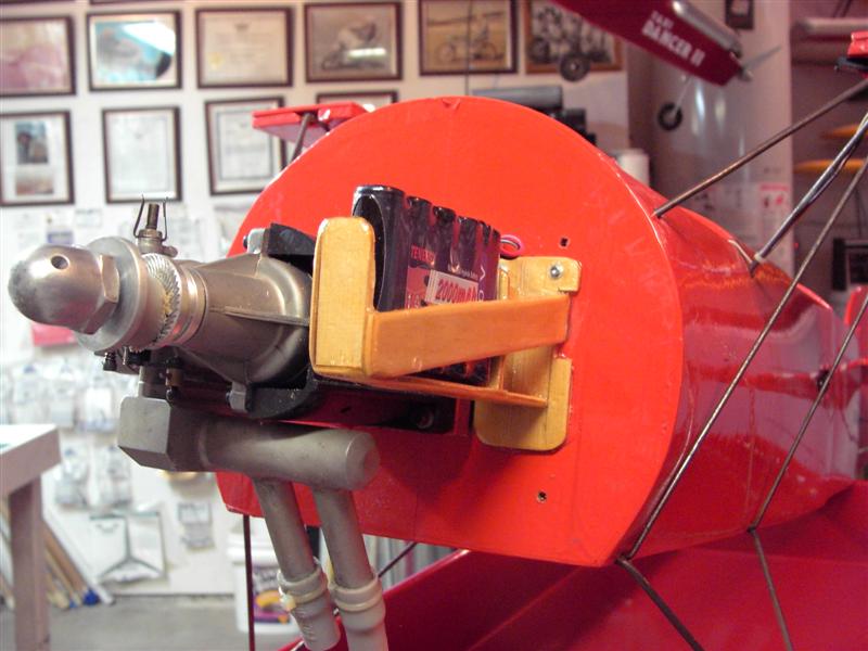

Sky raider I with an OS 46 LA is a little tail heavy and already under powered...Instead of adding weight up front how much impact would removing the two long screws that hold the tail on and glueing the tail have? I know it's not much weight but it is way out on the tail.... ( plus I have the tail apart as I just rammed the doorway with the tail bringing it into the house@&$!*#. Minor repair )
I'm also moving the battery out from under the fuel tank and putting it under the engine. ( haven't figured out how to hold it there yet) By doing this I am able to remove 2.5oz of lead from the nose.
I'll also test 11x5 , 11x6 , 11x7 props this Saturday to see the effects..
How much impact is 2.5 oz going to make? (I,ll find out Saturday )

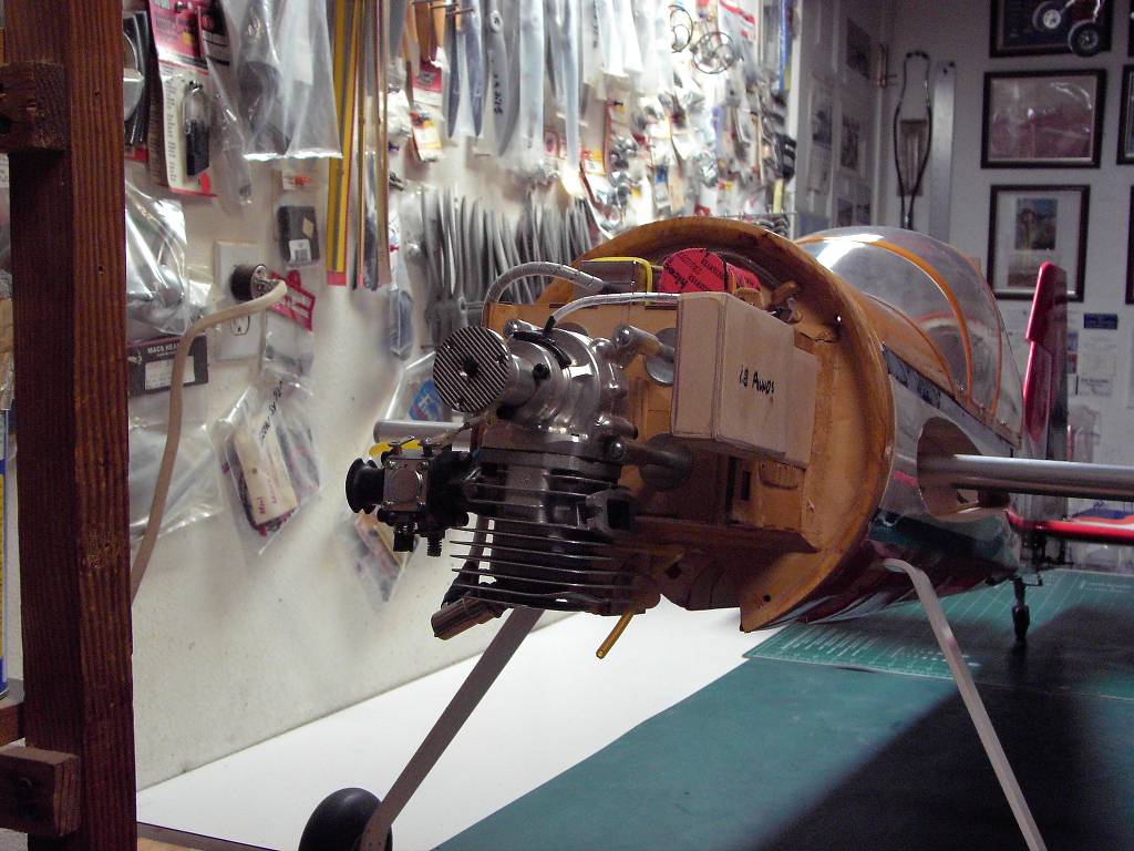

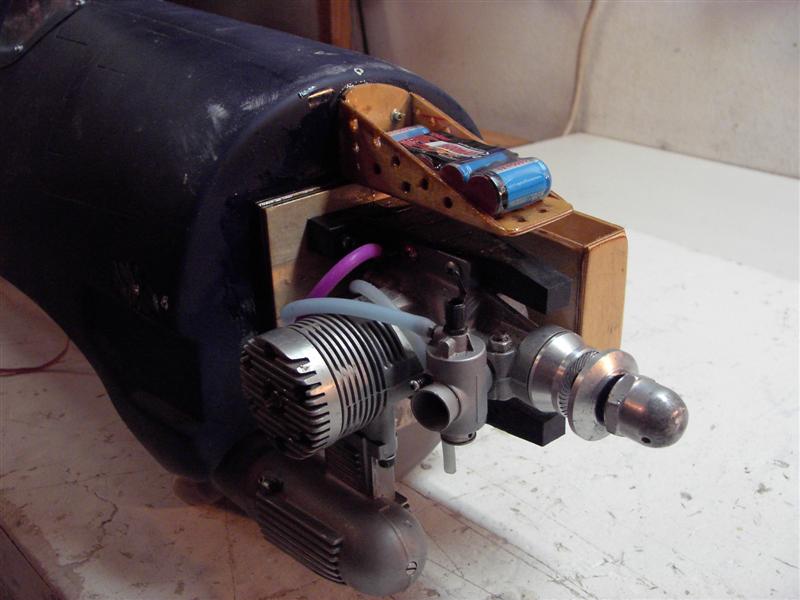

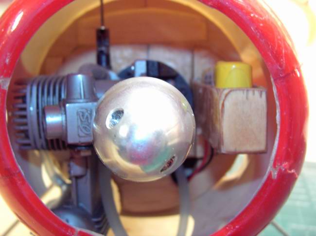

Looking at the World Models Skyraider 1 with cowl cheeks, only (apparent)way to mount the battery in front of the firewall would be to zip-tie it to the outside of one of the cowl cheeks.

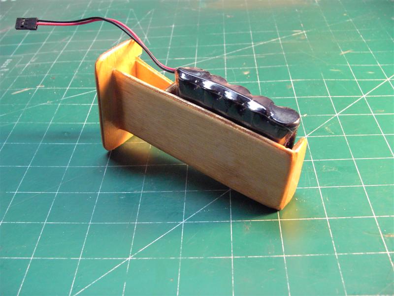

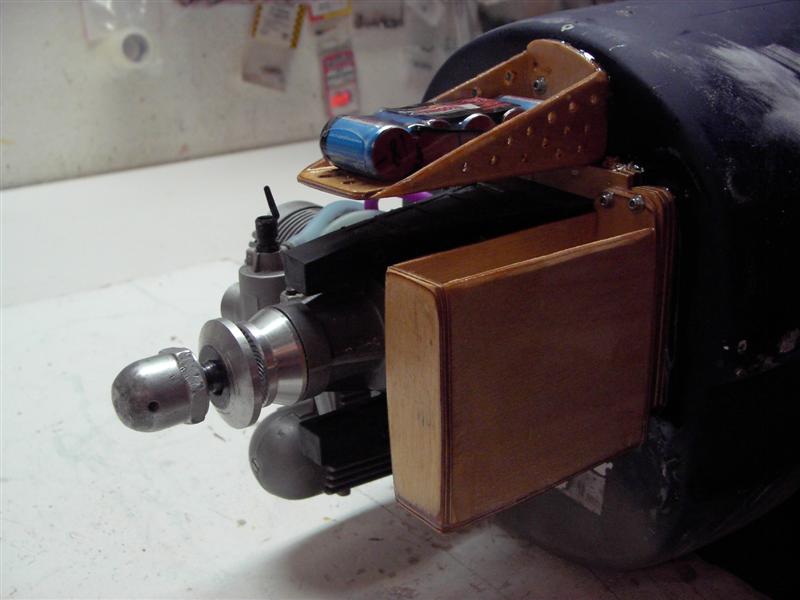

Thanks for the pics John, Thats what I'm thinking for the battery, just have to make it fit the space available...

I was going to refer you to John, he posted photos a while back of his battery mounts and they are slick. I'm sure someone will correct me if I'm wrong but as I recall the difference between tail weight and nose weight is about 3 to 1. Takes about 3 times the nose weight to 1 of the tail. The planes I really like and enjoy building all had round engines so before I ever start using the glue I know this ahead of time and try to lighten up the aft section during the build. Can't do this with an ARF but you can get the CG closer with gear placement. It's not a cure all but it helps to lessen the amount of weight needed in the nose. When I assemble an ARF for someone I make up a battery box like Johns. It really helps out a lot.
