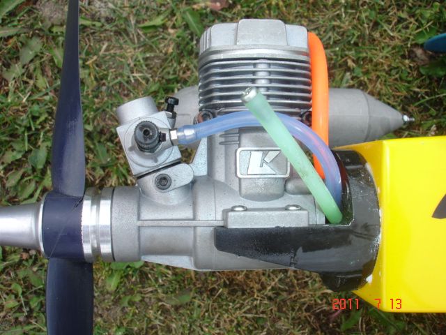

I am building 2 sig kougers with 2 different engines,they are set at 45 degree angle.how would be the best way to find the proper location to mount to the fire wall and be in the center of thecowl? I have one mounted after much trial and error and putting the blind nuts in the wrong place,there has to be a better way.... HELP!!!!!

There should be a mark on the firewall a cross....or the plans will have a cross...this is the thrust line and off set.....the intersection of the cross should be dead center on the back of the engine.....or you can do some measuring like you're mounting the engine straight and just turn everything 45 deg

Now the technique I prefer is to mark the center line on the firewall as above wherever you want the propshaft to come out and mount the engine on the mount.
Next hold the fuselage between your knees sitting down and look straight at the front of the airplane and rotate/position the engine/mount exactly where you want it.
Use the Great Planes hole locater:
http://www3.towerhobbies.com/cgi-bin...&I=LXK378&P=RF
and insert it through the mount in each of the four firewall holes and turn a few turns. Remove the engine/mount and you have four perfectly located firewall holes to drill and install T nuts.

Hi!
Agree! Dave Brown has the best engine mounts!
This is how I do it!
Just bolt the engine to the engine mount with self tapping metal screws or drill and tap the mounts and use either 3mm, 3,5mm or 4mm screws depending on engine size.
Second: Take the mount/engine and hold it against the fire wall and see to that it lines up with the fuselage sides . Most of the time the engine should point straight forward! Then spot glue the mount on with medium or thin Ca glue using accelerator.
Third: Drill holes through the mount into the firewall, put in blind nuts from behind, and screw the mount firmly to the firewall...That easy! I usually don't remove the mount after glueing it on!

Thanks. i used a dave brown mount on the second kouger instead of the two piece that came with the kit, it worked out great. very easy.

Something I tried recently was to position as close as possible on the firewall and drill the holes. Then make a plywood ring to match the back of the engine mount including the mounting holes. Put the blind nuts in the plywood ring. Enlarge the holes in the firewall to allow the bolt some movement. Now bolt the mount through the firewall and into the plywood ring with the blind nuts. You can then loosen the mounting bolts and move the mount within the confines of the enlarged firewall holes.

Put the engine in its mount.
Grind/snap the points off a 4-40, 6-32, or 8-32 blind nut (whichever one's shank looks like it'll fit in the mount's firewall holes.
Sharpen the end of 4 of whatever bolts fit your blind nuts to a point.
Run suitable nuts down the sharpened bolts a ways, insert bolts through the mount, spin the mod'd blind nuts on from the back and adjust the whole mess so you've just got some points about 1/16-3/32" long sticking up through the blind nuts. Lay the mount on a hard flat surface and adjust the depth of the points to they all make contact at the same time and there's no rocking from one being high. setting the thing on a small square of 1/16 or 3/32 balsa and screwing the points down until they just make contact with the surface will ensure you won't get a false read on the mount being parallel with the firewall. If you can't slip a sheet of notebook paper (about 3/1,000in) between the points and the hard flat surface, that's gonna be close enough.
Fit your cowl over the whole mess and when you're happy with the way thing are lining up, give a hard shove on the engine, and the points on the bolts will dimple the firewall. Those dimples are where you drill.
