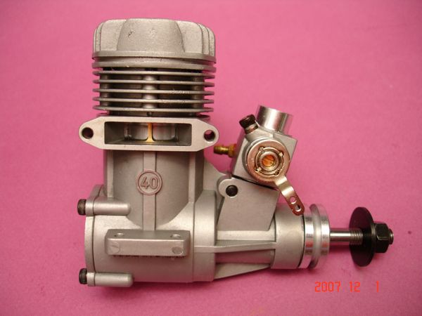

Old 03-23-2012 | 12:41 PM
Posts: 7,816
Received 10 Likes on 10 Posts
From: Upplands Vasby, SWEDEN
Default RE: Engine Vibration ..... please help
Hi!
No!
All TT .40-46 PRO SE engines have a two needle carb! Like nearly all other ball bearinge engines. pic shows the Kyosho GX.40 and SK .40.
Look on the left side of the carb (from the front). In the center of the throttle arm there is a small screw! That's the idle needle!
ID:	1741832   Click image for larger version
Old 03-23-2012 | 11:57 PM
Joined: May 2008
Posts: 180
From: PretoriaGuateng, SOUTH AFRICA
oh okay cool !! , thanx ive just checked ! , my screw is set horizontaly not verticly and the space between the screw and the engine block is about 20mm , so will have to unscrew it with plyers ,
so leme get this strait : does the plane idle better if the screw is turned more in or out ?
Old 03-24-2012 | 12:10 AM
JohnBuckner's Avatar
Posts: 10,441
Received 11 Likes on 11 Posts
From: Kingman, AZ
DK you are looking at the wrong screw. Look at Jakas picture agine the one on the left, now find the throttle arm (that is where you hook up the pushrod from the throttle servo). Inside this throttle arm where it pivots is a hole and you can see inside this hole a tiny screw with a screwdriver slot. This is the mid range needle valve on a TT Pro and on the engines in Jaka's photos.
