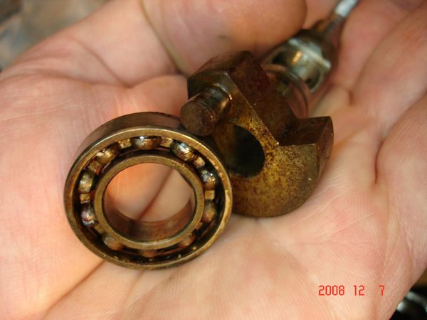

no it idles the same with glow driver on / off ..... i noticed yesterday when i took off the backplate .... there is some kind of Rust like discoloration on the cam ... almost like a brown varnish type color ..... what does this mean ????? is it bad news ??????
ORIGINAL: dirt kicker

Hi!
Brown colour means RUST! And steel rust!
If it's comming from the ball bearing it's bad news!
Third picture shows how it shoudn't look like!
My Feedback: (-1)
Great Photos Jaka!!!!!!!!!!!!!! Outstanding, nice and clear. A point of my own, I have opened up engines and most all of them have a coating of rust on the back of the crank, not as bad as Jaka is showing. Don't over think or worry about it, just the nature of the beast and something I clean up in the rebuild. However, the bearings are another story and if there is rust in them then I replace them.
Really good photos!!

Back to your engine issues: Do your bearings feel smooth and slick? If not, that is likely the cause of your idling problems. I was assuming a new engine in your original post but if it's old and been sitting up for a long time the bearings could be rusty or gummed up with old castor. Both will cause increased friction which kills your idle and reduces top end RPM.

thanx for the replys and jaka for the pictures (agan) lol !!
now that you guys mention , if the motor is warm , say i put a hair dryer on it , to warm it up , or its been running .... it turns smooth ! the prop does a full 360 degree rotation if i just flick it with ,my finger , but if its cold and i flick it , it feels sticky and only does a 170 degree rotation , before i start ripping my engine apart ,,,, which i REALLY dont want to do ... what oils or sprays such as Q20 , fluidfilm or WD40 can i use to spray on the bearing ?? i knw i sound so stupid askiing these questions ,,,, but its my 1st nitro engine
