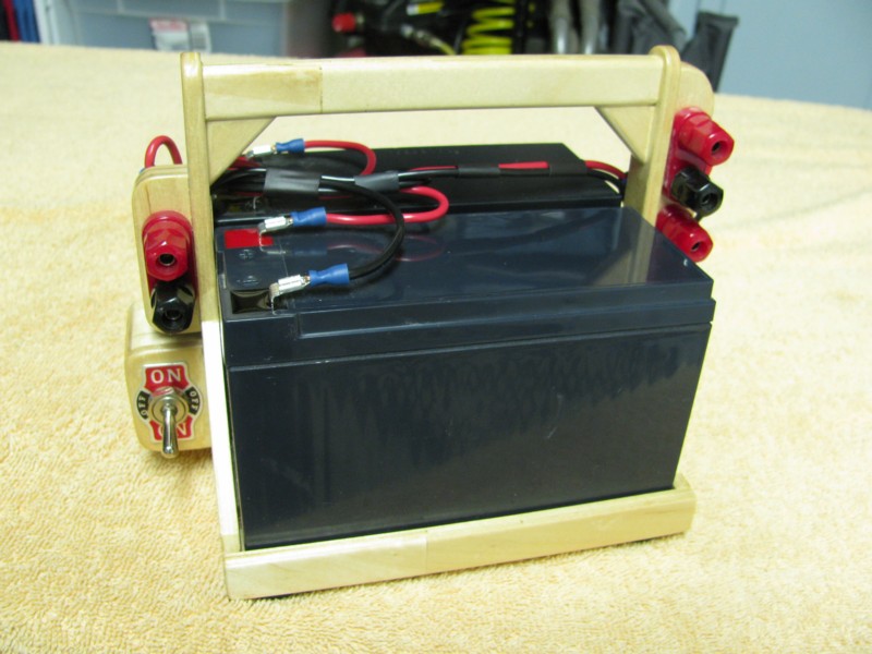

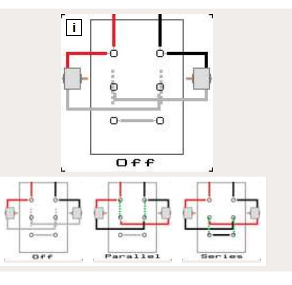

ORIGINAL: mrcoolpop
I been searching the threads for a diagram on how to setup 2 batteries for 12/24 volts converision. Do anyone have the setup for this.
I recently built a two battery setup with a switch from Radio Shack that allows switching between parallel and series to allow me to use my Dynatron starter with 24v when needed. Heres the wiring diagram and the switch is a DPDT (dual pole/dual throw).

Old 05-13-2012 | 06:40 AM
CGRetired's Avatar
Joined: Sep 2004
Posts: 8,999
From: Galloway, NJ
Default RE: Battery Setup for 24 Volts
That looks pretty good. The only concern for those that would think about something like this, is to make darned sure the switches are capable of handling the current that will flow through them. If it were me, I'd get something that was at least 50% more than what you figure you will need. For instance, if your current draw is at about 20 amps, I would definitely make sure the switch can easily handle 30 amps.
Just remember that series devices are "voltage" devices in that the "available" current remains the same but the voltage is a factor of the number of cells in series, where parallel devices are "current" devices in that the voltage remains the same no matter how many cells you have where the current available is a factor of the number of cells in parallel.
CGr.
Old 05-13-2012 | 07:12 AM
Joined: Feb 2011
Posts: 90
From: Edmond, OK
ORIGINAL: CGRetired
CGr.
Agreed. The switch is rated 10A @ 125v, soI would think good to around 40A or more @ 24v. It's part # 275-1533 and found here on their website. It was a stocked item at my local store and only cost a few $.
