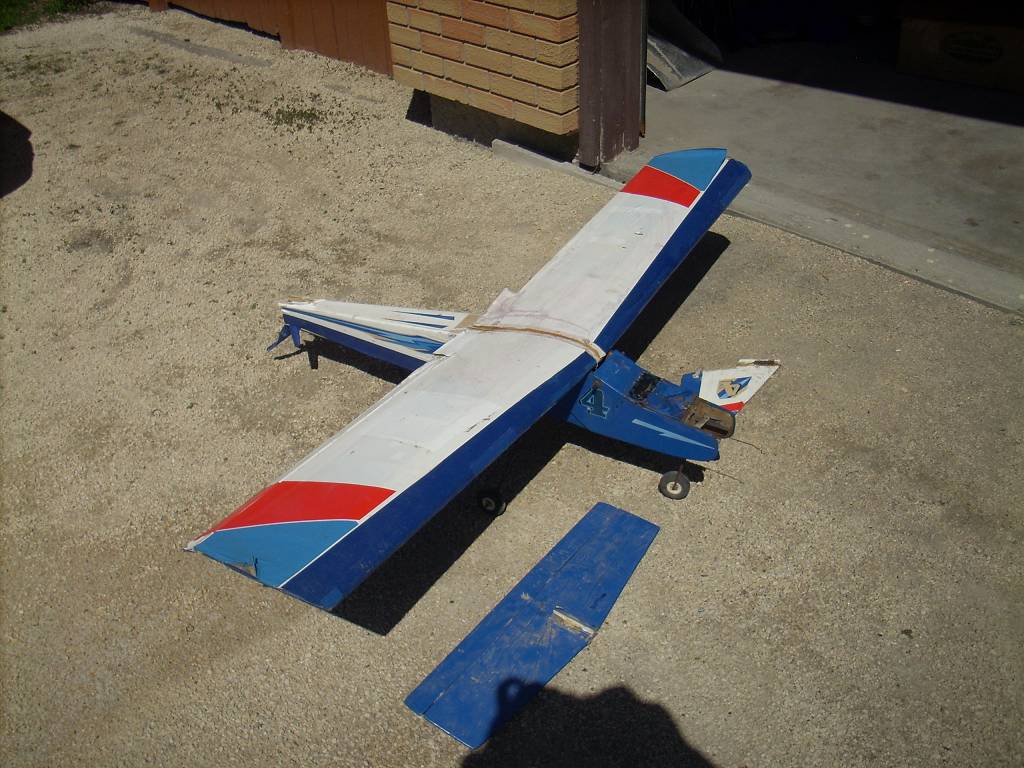

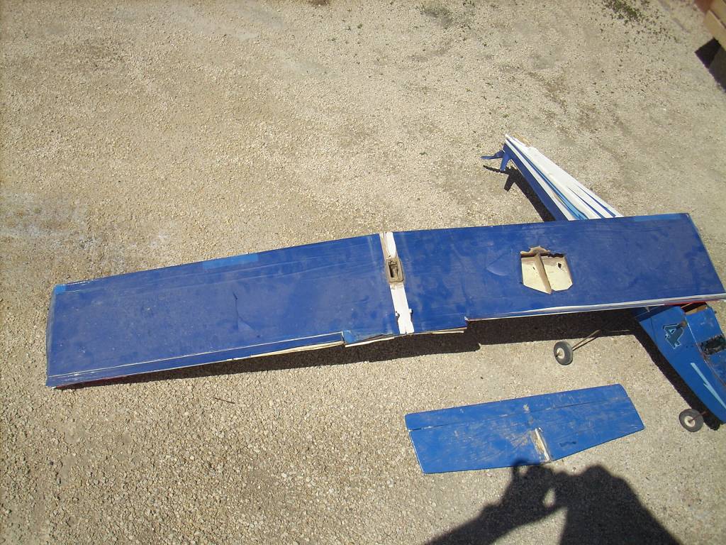

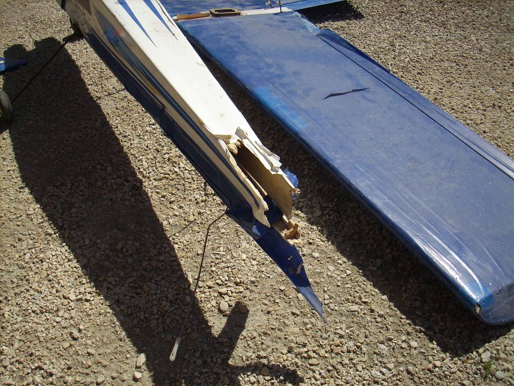

Hi there. I just bought an older crashed trainer and need some help. It was sitting a couple years, and was told that a mouse got into it. So I completey stripped this thing of all hardware and electronics. It is now an empty mostly-there trainer. As well, the main fuse area is dirty from dirt, cob-webs, etc. What can one use to clean up the inside of this thing? Pressure washer, garden hose, or would that affect the wood. This is just going to be a beater trainer for playing around with, and was told by others to totally scrap this one, and buy new. What are your opinions. The front was already repaired and is solid, just the tail is broken now. Also any help identifying would be great. OS LA 40, 64" wingspan tip-to-tip. Thank you.

That looks like a Kadet. Get some simple green to clean up the covering. If it is a Kadet, they make great trainers.

It is a balsa sheeted fuse, no lightening holes, etc. All fuse covering is off now for repairs. Wing is in good overall shape. Just needs a few small patches. Thanks for the help.

its a bit of a project, but learning how to build and rebuild is as important as learning to fly.
Certainly suitable for a trainer.
Mount the main wing before re gluing the rear stab and line it up squarelly, epoxy would be best for a good bond

as for the plane it would be handy to have the remaining bits of the fuse to get the rite H stab incidence otherwise the repair looks pretty minor in its condition just patch the areas where the film is ripped and get the tail feathers on strait and fly it like ya stole it if it survives you could recover it later but have fun first

That's an Easy Fly 40 from Hangar 9 - you can download the manual from their web site.  I had one as my primary trainer and fall back airplane for years.  Can't tell you how many times I crashed, er hard landed  that thing and kept putting her back together.
I used Orange cleaner on her for the covering but eventually replaced the Ultracote covering with Monokote.  And K2R works wonders for inside cleaning - soaks up fuel and vacumes well.

Awesome, thank you. This helps a large deal to rebuild the tail section. There is a picture in the manual that explains it all to me now. Thanks again for all the great replies.
